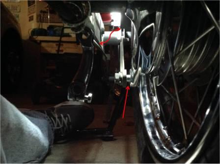

Post by primer63 » Sat Feb 01, 2014 10:15 pm
Bob750 wrote:I'm resurrecting this thread because I'm having my own issue with this sub-assembly.
On our early '64 Dream 305, we have the rear brake panel with the recessed hex on the inside, but the shouldered bolt that would go there can't clear the wheel hub. This bike had two similar bolts that only differed in length. I used the short one at the swingarm end and when I tried to install the panel end bolt, it wouldn't clear the wheel hub. It's possible that the shorter one would work at the panel, but the longer one wouldn't work properly at the swingarm. I guess I could remove the short one and test it at the panel, but my cotter pin is so nicely secured... :-/
Since I can't be sure the bolts in question that came on this bike are correct, can anyone say which part number is for the shorter one or the longer one?
I'm pretty sure the long bolt will work on the panel if I remove the axle bolt, drop the spacer away, pull the brake panel out, put the bolt in from the back, and put it all back together. I guess that's what I'll try tomorrow. Seems like a strange requirement to put that bolt in... Any other thoughts?
When I got back to my '61 Dream project today, I did so with an entire work week to ponder the differences that cause the offset between the surface of the brake hub tab and the tab on the swingarm. The difference I found today is that the distance from the inside surface of the swingarm, to the closest surface of the tab is 2" on the '61 (shown), and it is 2-1/8" on the '65. (see curvy red arrow) You can see the offset difference on the bolt (see straight red arrow). If I use the 61 swingarm, I'll have to put some washers on there to take up the offset, or use the '65 swingarm.
There doesn't seem to be any difference in the height of the brake hubs (measuring inboard to outboard) between the two model years, although they do look different in other ways.
I'm not sure if this helps at all, but thought I would provide some observations on my particular bike build.

We'll after all that explanation with circles and arrows and an explanation about what it was (to paraphrase Arlo Guthrie in Alice's Restaurant) I discovered that I had attached the bar both upside down and backwards. The bar has a slight offset to it and once properly oriented, eliminated the gap and need for washers on the brake hub end.
