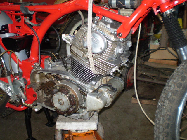

I wrestled the engine out of the frame today and flipped it ready for the transmission analysis. But on the way, I disassembled the starter planetary reduction gearset. The motor would run, but not turn the engine. I figured probably a bad freewheel clutch, but it was tight when I tugged on the top run of the chain, and freewheeled when I pulled on the bottom run.
However, when I pulled the gearset apart, the ring gear (outside the planetary gears) was not fixed to the housing, but free to turn. Well that could sure explain the starter problem!
What is supposed to fix that ring gear? It has a "notch" on its outer radius, but there is not a corresponding "tit" on the housing.
Anyway, I plan to extract the gears tomorrow, and will try to post photos of likely culprits ASAP.
