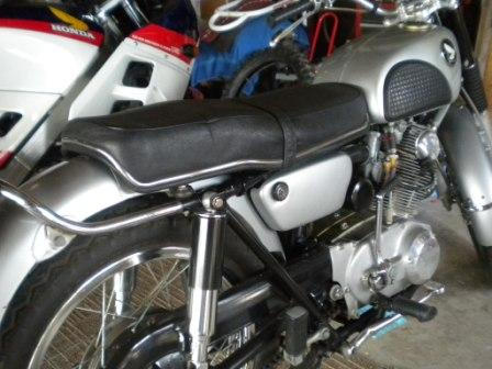

Ron, if it helps here are some pictures of my stock seat trim...............................D

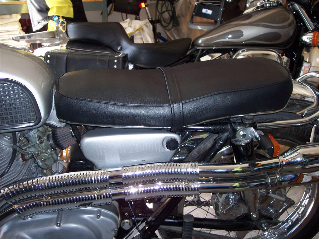

many thanks. Since my bike doesn't have the original trim and I just re-upholstered the seat more correctly, I purchased a flexible chrome trim from a cruiser customizing web site that needed to be cut to length and your pictures showed me just what to do. I see the original trim goes a little higher on the front than I did. I may redo mine as I have enough left to do it twice more. I've attached a photo of finished seat. It was rolled and pleated upholstery with no trim before today.

Ron, your seat looks great. Mine has about a 3/8" to 1/2" reveal between the trim and the bottom of the seat, and the upturns at the front are about an inch and a half long....D
