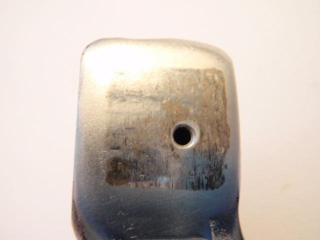

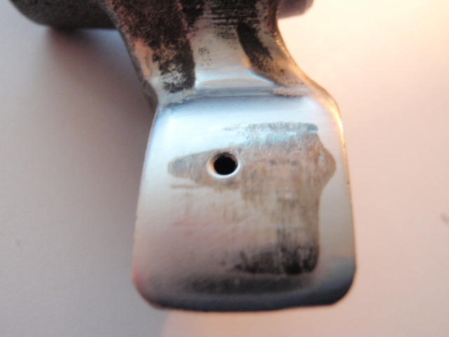

Hi
I once dissembled an engine with four of these "holed" rockers. I remember that the state the rockers were did varied a lot. The bike had done 13.000 km, and I noticed that it was probably never dissembled before. I kept three of them, but after all one is useless, it shows to much wear.
Maybe these rockers are more " sensitive" for (in)correct valve play.
The holed rockers are indeed not so common, but every once in a while, I come across them.
From the box of used rockers, but reusable, I counted 42 non holed rockers, and 7 holed ones.
rocker nr 2 was also in the box, but not anymore. nr. 1 and 3 are still good and useful.

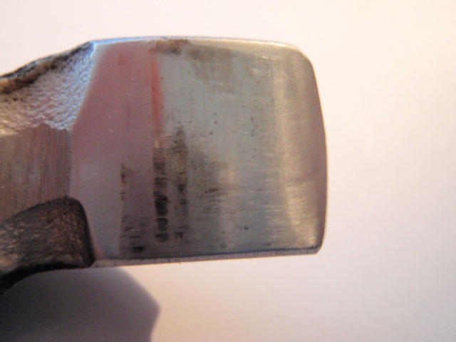

For reference of the pictures I took another one from a regular rocker.
Jensen
Jensen
Nice pics Jensen.
They show something I have noticed about the 810 issue.
The contact/wear area's usually aren't flat as the earlier issues usually are. ..........lm
