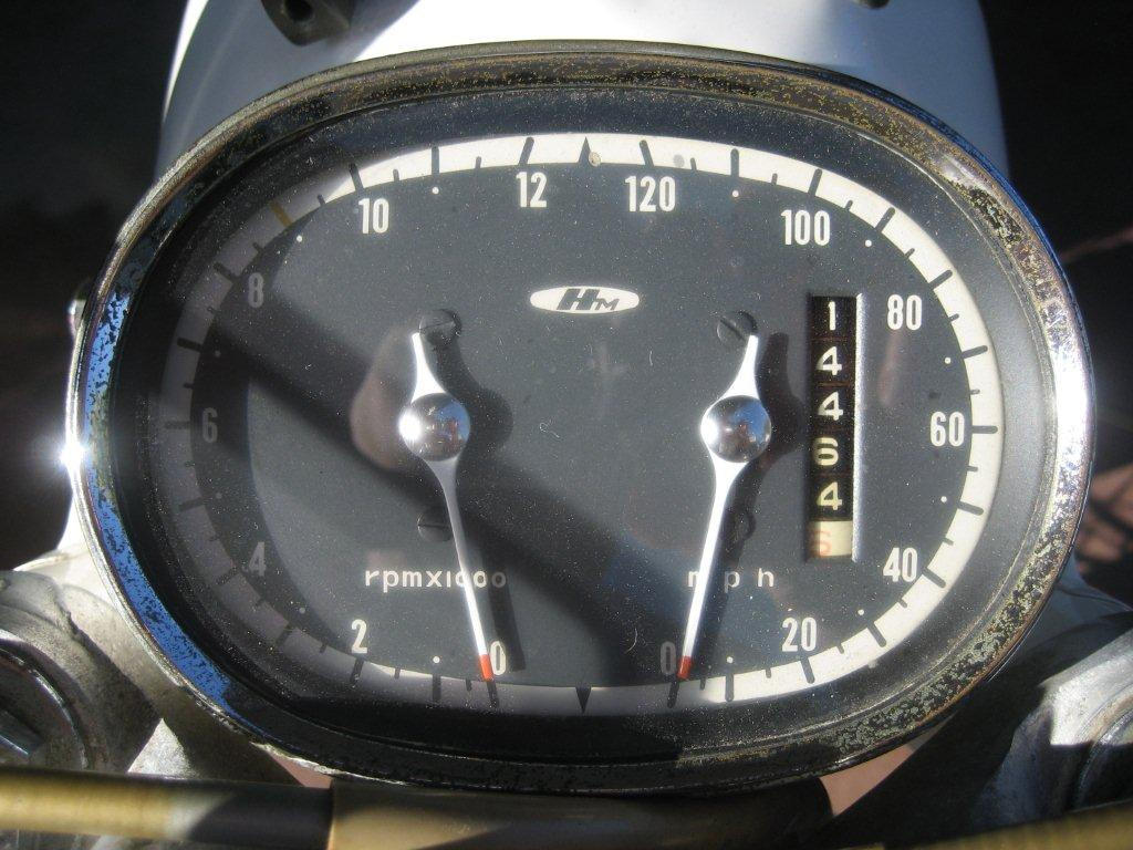

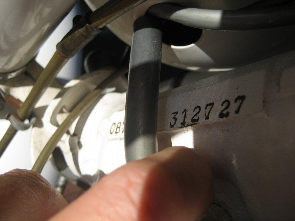

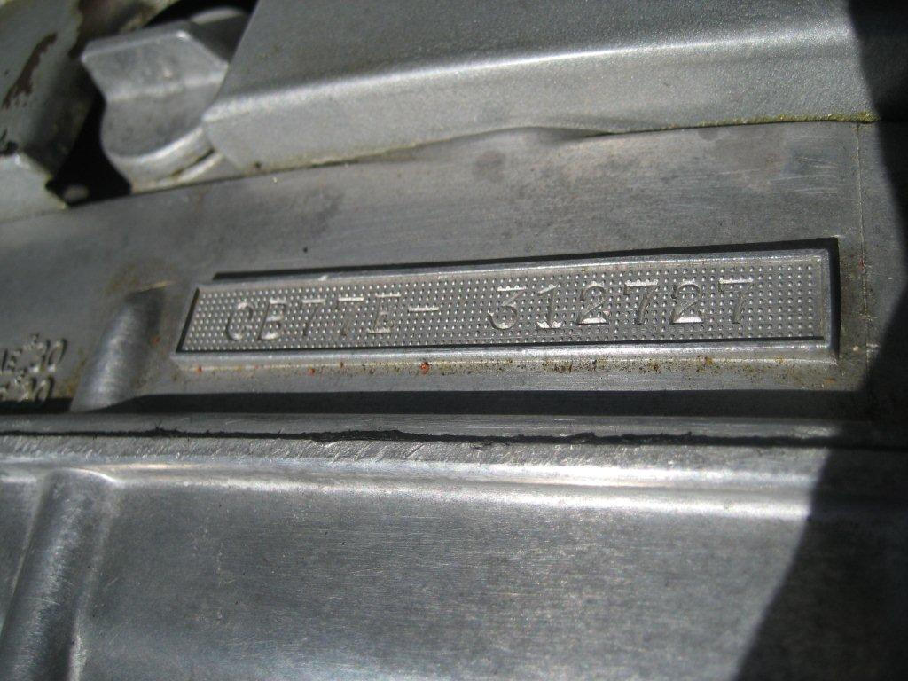

Here's a couple pics of the VIN numbers, but according to the FAQs, the instrument cluster doesn't have a high beam indicator like a '62...???

So I'm back from vacation and decide to pull off the tank and the wiring tag says "1962", Registered as a '62, Speedo is a '62, wire tag says '62, but VINs say it's a '63. ??? Could I have a late "62 or very early '63 production model? Hmmmm????

'63 productions were CB77-310001 to 319222, so yours is just over a quarter of the way in.
I know what I think, having seen the images of the numbers........ But that's the Holmes/Watson coming out in me!

What's even more beautiful is that the engine/Frame numbers are a perfect match. One of the few I've seen other than my own. I really like the white .

The bike has a 1961 speedo, late mufflers. and some strange early parts. The real date is a mystery because I think the frame numbers aren't original, as is the color of the bike.

jensen wrote: The real date is a mystery because I think the frame numbers aren't original, as is the color of the bike.
jensen
That's what I was thinking. I don't think they ever painted on numbers like that. Looks like someone ground down the frame and painted them on as I don't see any impressions. Of course it is hard to tell in the pic but it looks like there might be some grinding marks on the flat area. Possibly a stolen bike from long ago?

Post by Glenardo » Mon Sep 06, 2010 10:54 am
The VINs are definitely stamped not painted. The paint job looks original, or if not, they did a complete disassemble /stripped down paint job. I had the seat and tank off and there's no sign of any other original color under any scratches or wear marks. I thought I read somewhere that the CB77 came in white???
