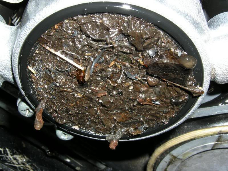

Do a search on the topic, Hoodoo. I posted a picture of a spare engine I was given in a bike deal. Oil screen was about 3/4 plugged with nasty sludge. That picture and Brewsky's should convince you of the value of filtration, regardless of the mesh size.
