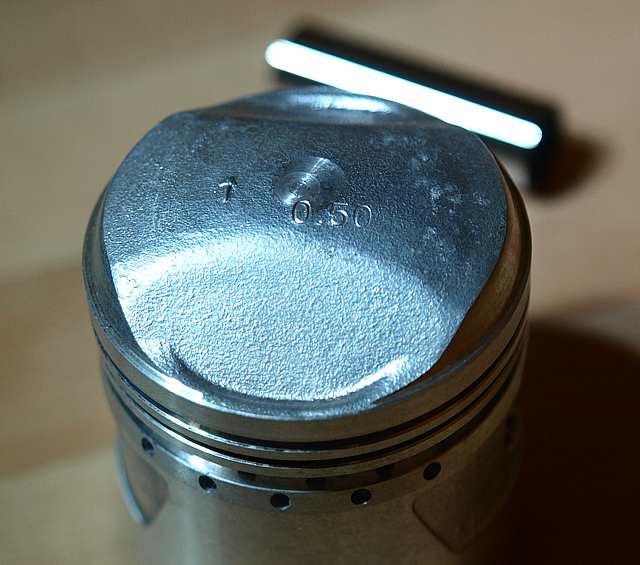

Post by G-Man » Tue Jan 11, 2011 12:16 pm
Adam
This is the type of marking you should look for. When measuring the piston, measure the diameter at the bottom of the skirt at 90 degrees to the wrist pin for best accuracy.
CB72 Piston. O.5mm oversize.

I was going to post another question, but seeing as how G-Man posted the picture of his piston (on the previous page), and this fits in with my question, I thought I'd ask it here.
I showed one of my pistons after I cleaned off all the carbon to a friend of mine that builds street rods and engines. The crown surface is about 75% pitted as if the carbon had eaten into it a bit, and he said that I should polish it up as much as I can (a mirror finish would be the best) because the smoother the finish is the less there is for the carbon to grab on to and accumulate. This makes sense to me, but so does UFO's and the Easter Bunny so what can I say. :-) I noticed the picture of G-Man's piston looks like it has a course finish on the whole surface which would the opposite of what my friend was telling me.
I spent the last 2 hours with a dremel tool and a buffing pad/compound attempting to buff out one of my pistons. It can be done but it is real slow going so I thought I should probably ask what the collective here thinks.
tnx
George
Post by LOUD MOUSE » Tue Jan 11, 2011 8:22 pm
My reply.
Carbon on the top of a piston is part of life when ya run GAS.
How much is in ratio as to many things and with a street engine will be there no matter polished or stock.
Racing engines are a totally different issue.
When ya assemble your engine are ya going to take it totally apart and clean the pistons and inspect all the parts every 5 hours running time?
I sure don't and I don't polish the piston tops or INTAKES (some will love that) as it is what it is and to enjoy it I recommend ya KISS (KEEP IT STOCK XXXXXX) AND RIDE, RIDE, RIDE. .............lm
