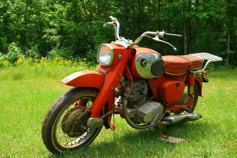

Hey Kellie thanks for the explaination for the life of me I couldn't find it threw a search?.. Don't have the VIN yet but I'll get it up tomorrow afternoon or tuesday. Guys just says its 60's I've attached a picture of the bike, I'm sure it doesn't help much since these didnt change much but maybe it will help for now? Not a huge deal if not of course.

Anyone wanna give this one a shot? Looks to me like it could be anywhere from a 1965 on up. But I could be wrong. Identifying the years is not my strong suit. Especially when it comes to the later models. I think the VIN would really help.

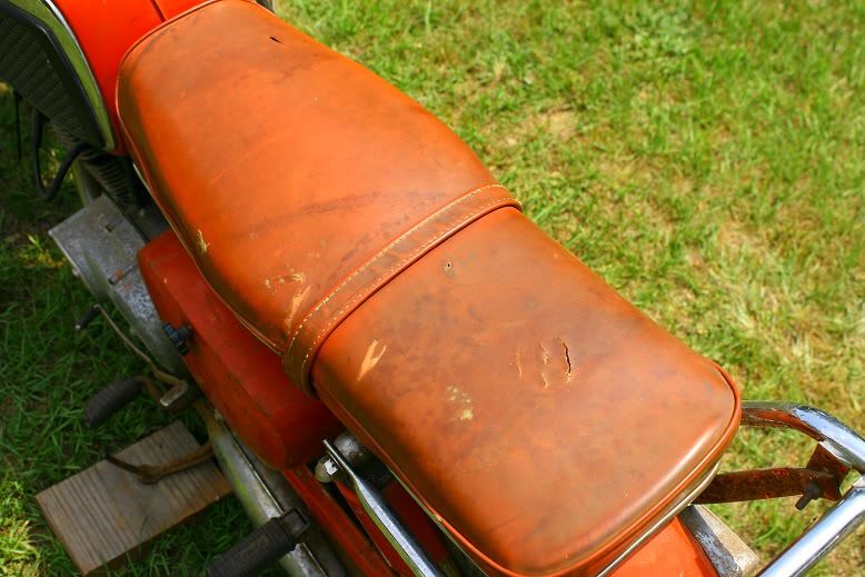

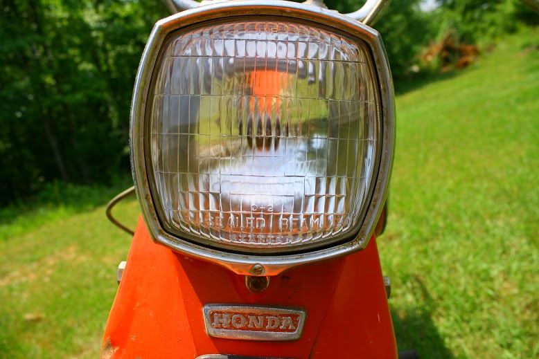

Sorry for the slow response and update fellas right after I picked it up monday me and the wife took off for Charleston and just got back this morning at 1am..... But now its picture time!
OG seat!
Nice lense
