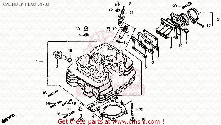

Reeds are used on some modern engines for air injection (smog) into exhaust ports, but I didn't know they were used in some 4 strokes in the intake
Google revealed this.....Honda XR500....supposedly increases low end torque...

Fascinating stuff. The earliest 4-stroke engines used a simple one-way valve for the inlet, just sucked open by the action of the piston going down.
It was replaced by the mechanically operated valve to increase engine operating speeds.
After 100 years or so, Honda seem to have combined the two to good effect. There really is nothing new, is there?.......
