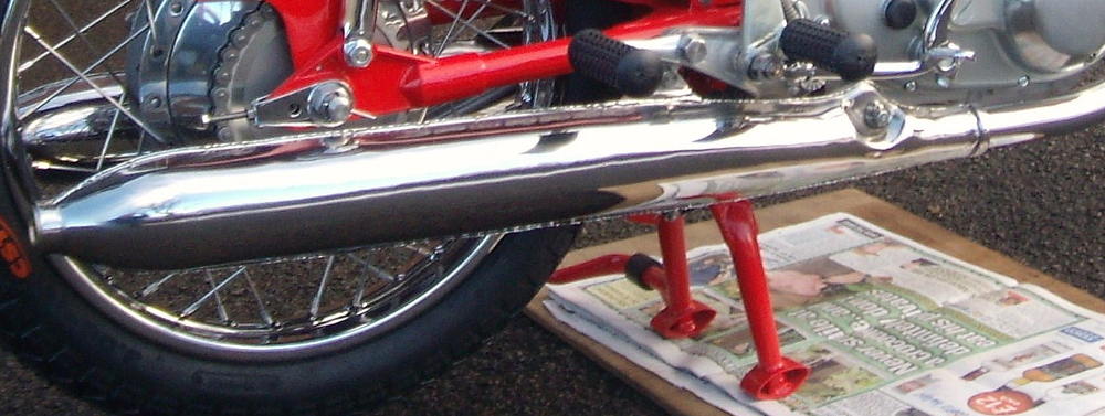

If they are stainless could the seam be split then the dents could be beaten out and the 2 halves welded back together again and re-polished, I have heard of this being done to chrome steel ones, which would also require re chroming after also.

I have a friend who does that but the stainless silencers are very thin and once the seam is split the two halves are very flexible. I have a stainless set that I want to try it with but I know it will be a long job.
Also - although they are stainless they are not completely immune to corrosion so you may find pitting on the inside. Possible but not a job for the faint-hearted.
Hard to believe but this is a stainless one one that he split open, beat the dents out of and had re-polished. Don't you just hate people who can do that!!

Agreed Graham, hate and admire at the same time :) That is an excellent piece of work.
