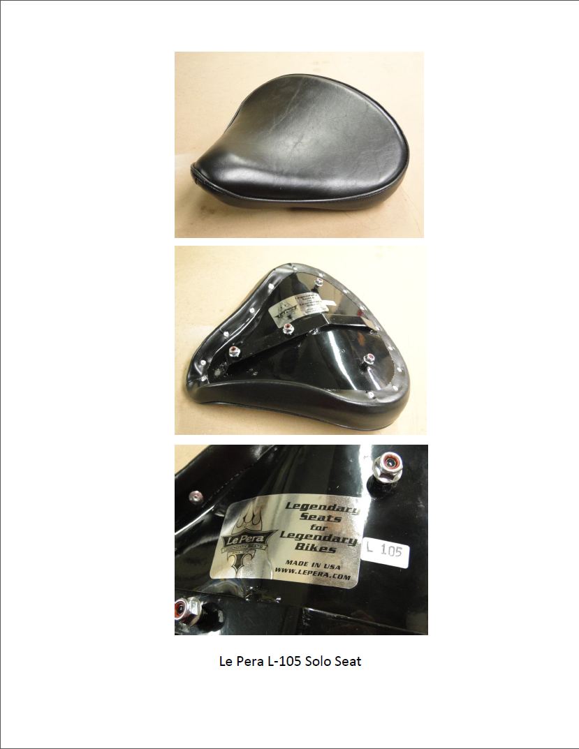

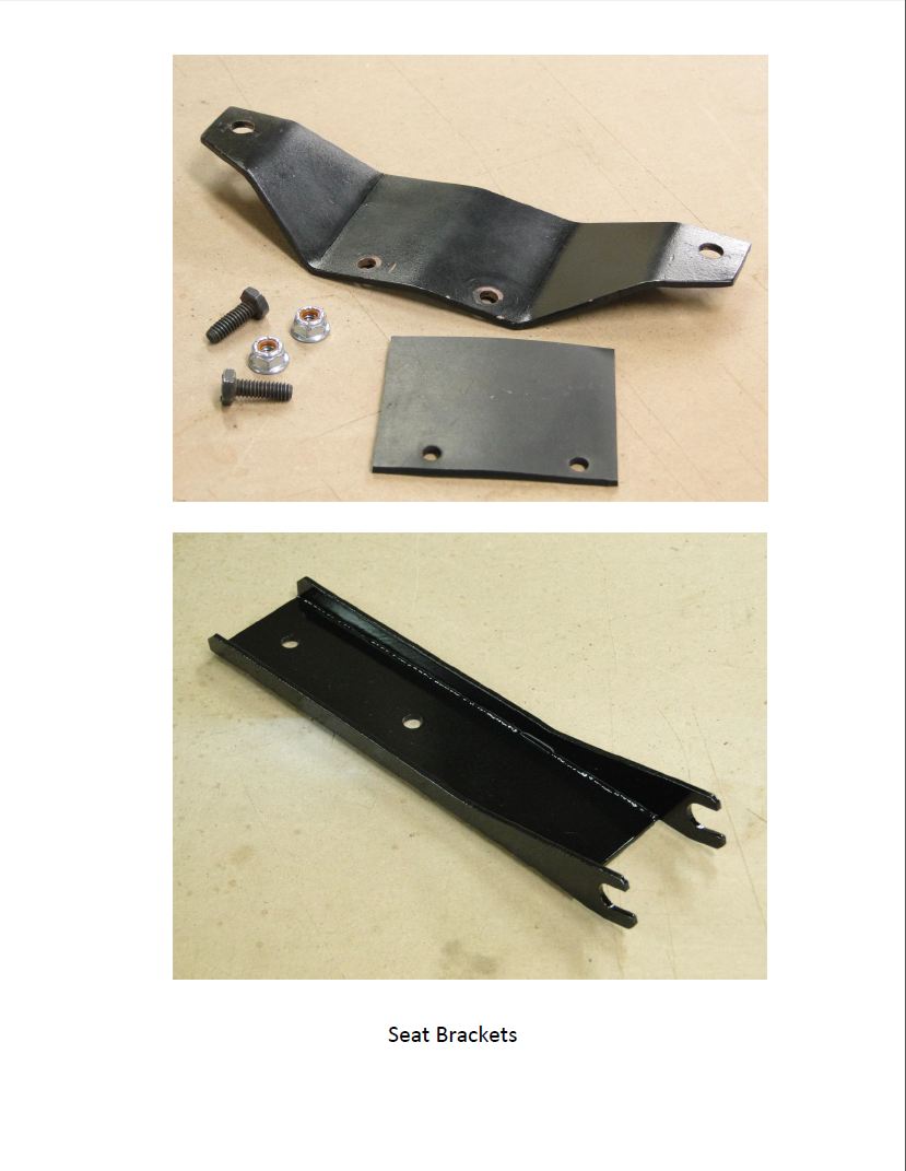

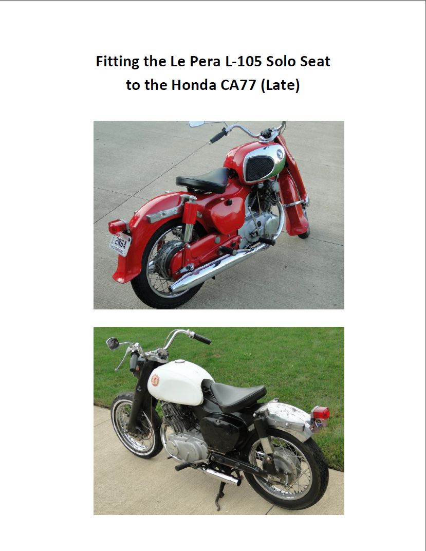

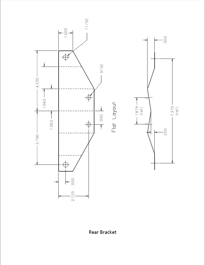

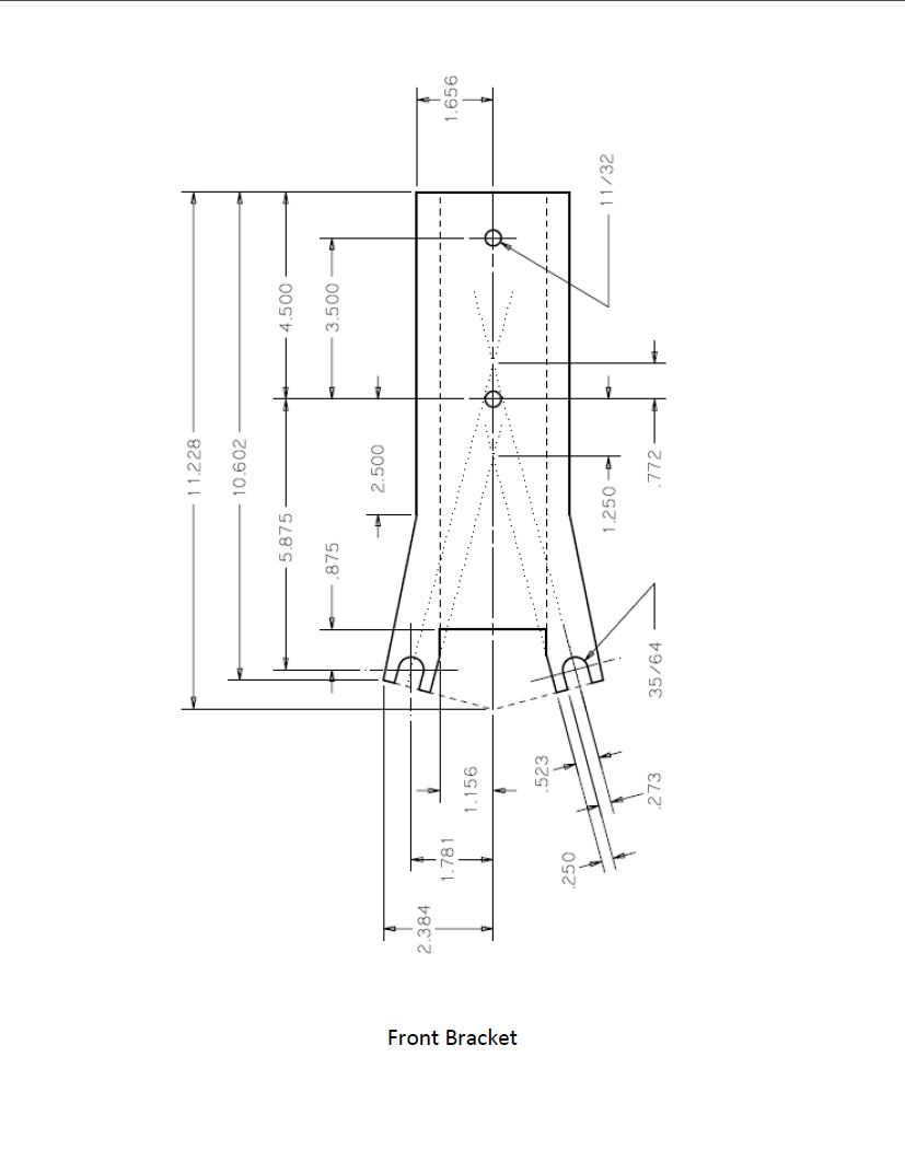

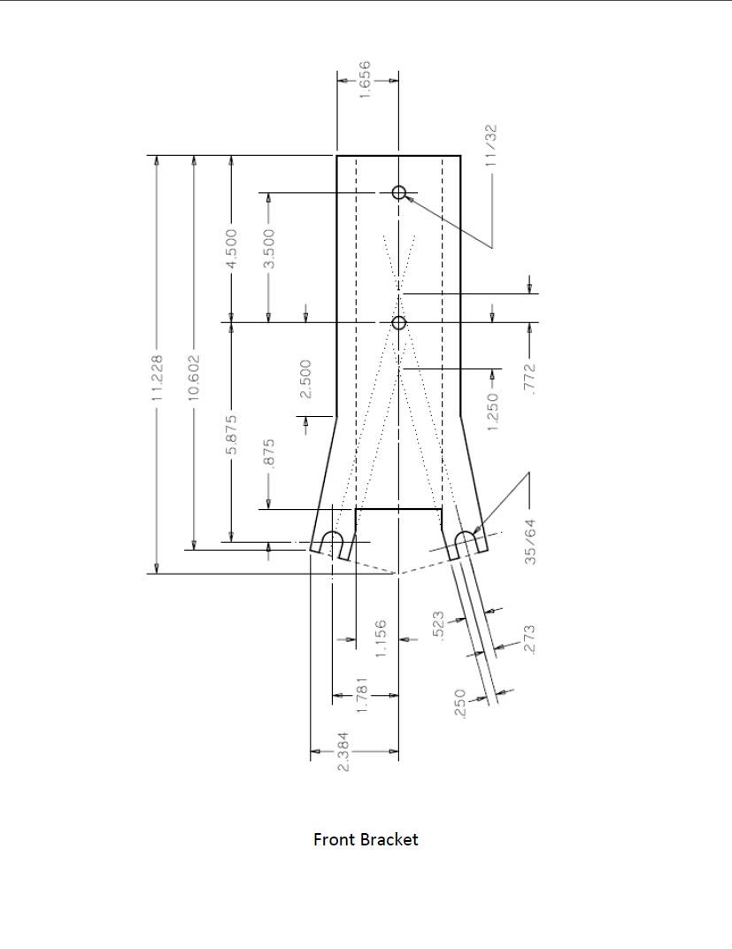

Email sent, and the 6 pages should appear below if all goes well...
48lesco
Posts: 721
Location: Olmsted Twp, Ohio
CA77 Solo Seat
Post by 48lesco » Wed Apr 08, 2015 12:20 pm
Close but no cigar. Max 5 attachments. Here's page 1
