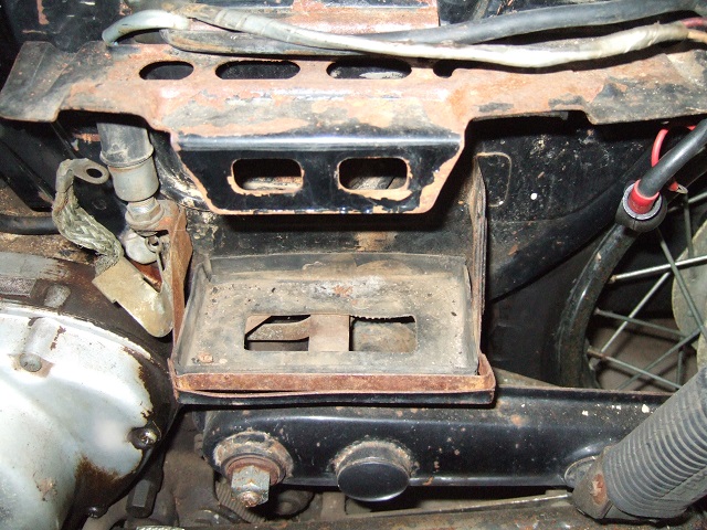

Post by wrencher » Mon May 18, 2015 10:01 pm
Here is a pic of the battery holder. the size is approx. 5½" long x 5" tall x 3½" wide.
does anyone know what battery this takes?
thanks

Post by Hoosier Tom » Thu May 21, 2015 1:52 pm
12N9-3A. Make sure the negative post is on the left side if you are looking at batteries that cross reference for CA77. MotoBatt makes a nice AGM battery, MB9U.
