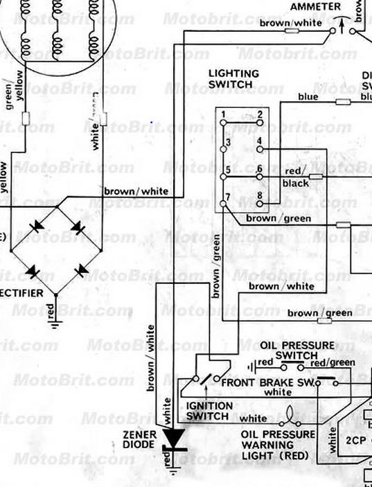

If you are using a Zener diode for regulating voltage, there MUST be a resistance between the voltage source (the stator) and the Zener because the Zener acts as a voltage clamp and will divert as much current to ground as it has to to maintain voltage. If you don't add resistance, you may overheat your stator. All of the energy that is "dumped" is wasted as heat.
I understand it is dumping the energy as heat, that is why I'm using a heat sink. Adding a resistor prior to the Zener would be dumping some of the heat there. Wouldn't that change the voltage that the Zener is sensing? Back when I was an electrician in the service we would install resistors to run 12 volt accessories on a 24 volt system, the resistor size being dependent on the load. Off hand I'm not sure how this would relate to the Zener sensing voltage.
If Honda designed this as a balanced system, we have unbalanced it with the silicone diodes in the rectifier when we made the system more efficient. In my initial testing the Zener was drawing .5 to .6 amps at high RPM with the lights on high beam. I have installed the Zener so that any current runs through the main fuse.
We're not working with a system comparable to a modern automotive alternator which is capable of putting out high amperage at low rpm. Since the British bikes use the Zener with a heat sink on a comparable system I'd think it should be a workable solution. I know there are better systems out there, just trying a low cost alternative. I could be proven wrong, wouldn't be the first time.

OldStan wrote:I understand it is dumping the energy as heat, that is why I'm using a heat sink. Adding a resistor prior to the Zener would be dumping some of the heat there. Wouldn't that change the voltage that the Zener is sensing?
No, it wouldn't. The Zener diode operates as a voltage clamp. At any voltage below the Zener voltage, the Zener diode does nothing - it's like it isn't even there. But, as the voltage tries to rise ABOVE the Zener voltage, the diode will dump as much current to ground as it has to to maintain the Zener voltage - up to the point where the Zener diode melts - which is exactly what would happen if there was no resistance in the supply circuit.
If you don't add a resistor in the supply circuit, the resistance of your stator will perform that function and the heat will be dissipated in the stator. That may or may not damage your stator. If the stator were wound with heavy wire, either it will fail or you Zener will fail.
It was never "balanced". Honda designed the charging system with "the technology of the day" and would have boosted the stator voltage to get the charging current they wanted through the higher resistance of the Selenium rectifiers.
OldStan
Posts: 548
Location: Galt, California
Post by OldStan » Mon Jul 27, 2015 11:32 am
Here's how Triumph did it on the late 60's.
