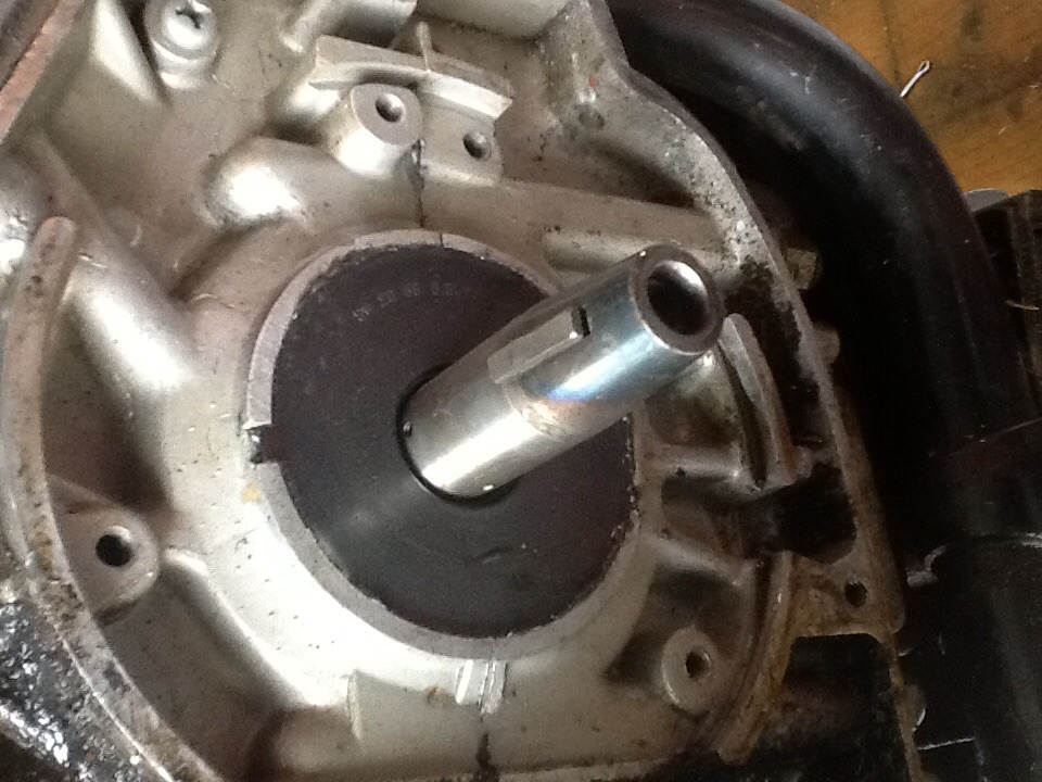

Found a bolt! So now the rotor is off. I'm assuming the seal is behind the black metal cover. The cover is well sealed with a nice bead of grey silicone leaking through the gap, but the oil seemed to be coming from behind the stator.
Does this cover just pry off?
Post by G-Man » Sun Feb 07, 2016 4:03 pm
The black part you can see is the seal. I can see some drillings in the shaft next to the seal. If you have a CL those shouldn't be there as they lubricate the starter sprocket bearing on a CB. Can you poke anything in to those holes? How far?

Post by connor1 » Sun Feb 07, 2016 4:17 pm
I was able to probe a small diameter stiff wire 1.75 cm straight down in to the shaft. The hole is at 12 o'clock. The other image that appears to be a hole is bit of dirt.
Hope oil I can't leak out of that hole...no starter to lube up on this bike.
Now that I open my pack of seals I see one that matches up to that large black disk!
Any ideas/advice on prying this seal out?
