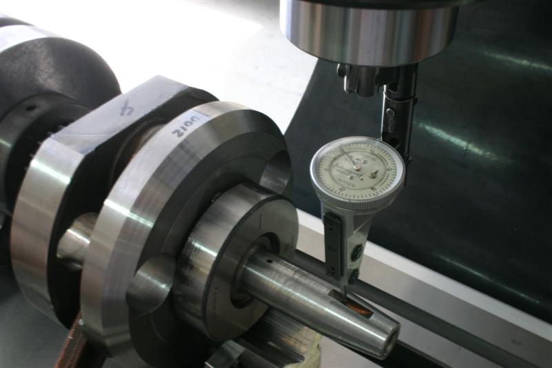

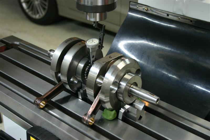

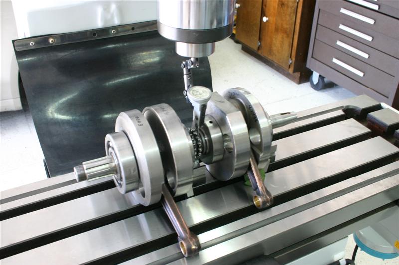

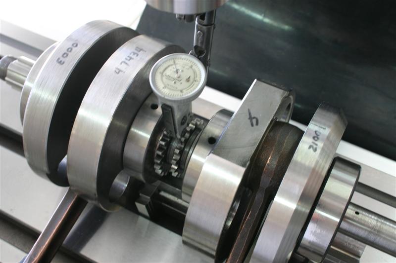

I put my finished Dream-SuperHawk crank on the mill to check the orientation of the cam sprocket tooth to centerline of the stator keyway on the end of the crank.
I set the crank on V blocks butted to gage blocks in the table slot, using the end and center bearings of the crank. I trammed for C/L, first on the primary end of the crank, then the stator end; this established the crankshaft to be straight [it was within .0005" end to end]. Then I rotated the crank in the V's until the keyway was dead centered, and a little clay on one flywheel to keep it from wanting to move. I then moved the table to indicate the cam sprocket. The tooth was .0054" off center. Out of curiosity, I then repeated the above with my SuperHawk crank from my runner. The crank was never taken apart, and as it was from the factory. To my surprise, it was .013"off center. To translate this to degrees rotation of the cam sprocket to the stator keyway, I put a new cam chain over the sprocket, measured over the rollers to determine the center-to-center radius of the sprocket. I then plugged in my numbers, and my cam sprocket tooth was off .595 degrees, and the factory crank was off 1.281 degrees.

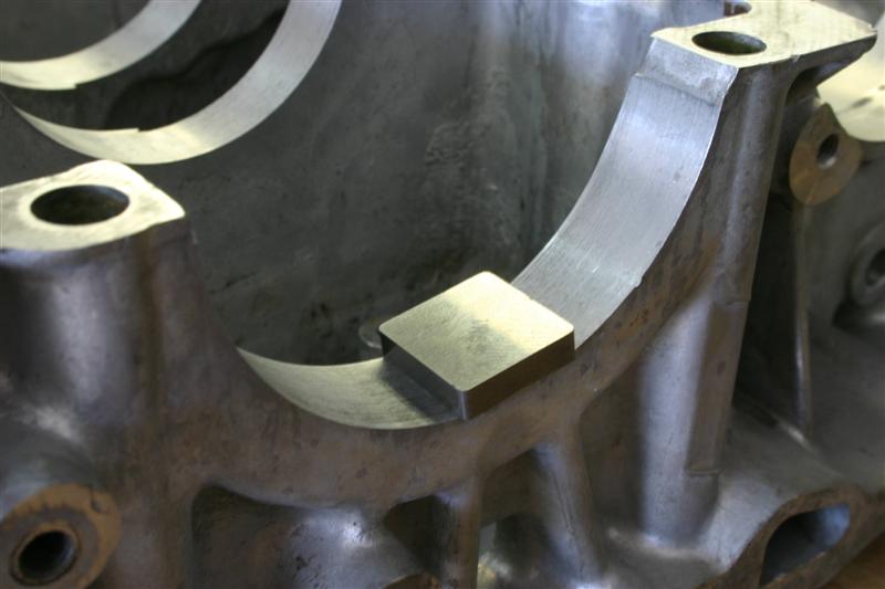

As a side note, when I was checking/truing my crank, using the case half, as Graham had in his crank rebuild, I noticed a couple of small dings in the bearing bores. What really works quite well to remove these is a fresh square carbide insert. It will center itself in the bore, and only remove the high spots. Just carefully move it along the surface of the bore, and you can feel it hit and remove high spots. If they are very pronounced, first use a fine swiss pattern needle file - very gingerly! Then follow it up with the carbide. This process will insure the integrity of the bore, and not remove an excess amount as with sandpaper.
