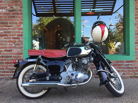

Nick - you solved my problem (as embarrassed as I am) with this simple suggestion! I've been struggling with this for longer than I care to admit and I suspect the previous owner did as well since they showed me how they use the choke.
She has never run so well! Now I can actually tune the carb...
Thanks again... This IT guy who is usually the one pointing out the obvious just got a taste of my own medicine.
