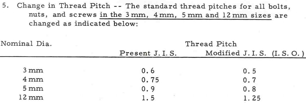

I've been wanting to mount the "300" badges from Ray Byrne for a while since I just don't like the metal replacement badges from Honda.
However... it always seemed I received the wrong screws from different sellers... Thought I got ISO again and again because they didn't fit.
Left: my old screws that fit
Right: JIS screws from Ray Byrne
There seems to be a very small difference in pitch?

Post by malcolmgb » Mon Jan 30, 2017 4:43 pm
copy of Honda JIS to ISO thread changes.
