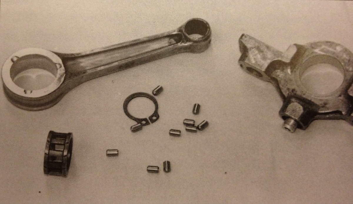

Thanks for that info Jerry. G-Man, do you happen to have that photo? If you have, would it be possible to see a copy of it please? It really puzzles me! I was looking at a picture of the RC 116 engine in Honda Racing Legends Vol 3 (P65) and it clearly shows the 2 slot cage and rollers. I'm not trying to start an argument about this. Just trying to find a reasonable answer. Any comments will be appreciated.
Post by G-Man » Fri Jan 20, 2012 1:37 pm
Hi
This is out of a French book titled Mike Hailwood et la Honda 6 page 107.
If you are interested (and can read French) the ISBN is 2-263-02220-1
Cheers

Post by jerry » Fri Jan 20, 2012 4:02 pm
The grooves in the cage originate from a Pops Yoshimura modification from when he was involved with Honda. It helps the oil flow through the assembly to both minimise wedging and dissipate heat. Nice photo. All the best Jerry
