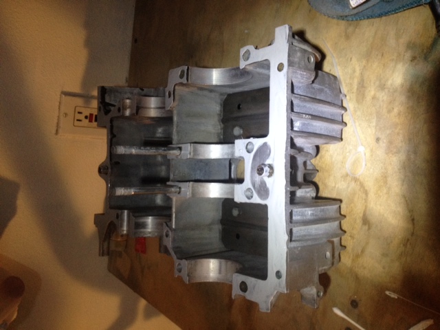

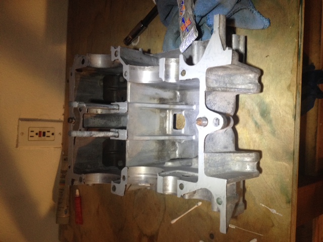

Brickyard wrote:At this point I'm pretty nervous as this is the first time I've split the cases and put them back together. The worry of "maybe I forgot something" is hard to overcome, but I checked and checked again. Bill Silver said an alternative to Hondabond is this permatex ultimate gasket maker; it's what I have, so it's what I'll use...

LM, i planned on using sealant only on the case mating surfaces.
I havent seen thread locker in Bill Silver's book, but then again I think it was written 22 years ago.
What do you suggest?

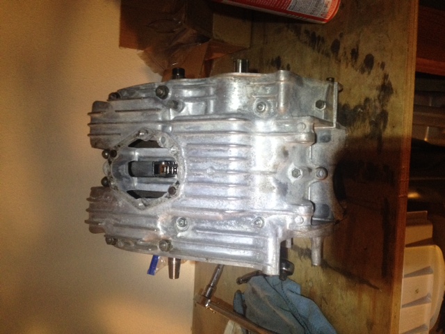

Used a rubber glove and did my best to evenly apply sealant to mating surfaces as LM suggested in the past, but stayed away from the crescent shaped oil port up front.
Torqued 14mm nuts to 15 ft./lbs, but when i attempted to do the same for the 10mm nuts/bolts, i backed off after hearing a couple studs stretch.
Should these 10mm bolts/nuts be torqued down to 15ft./lbs, or should they be "snug?'
