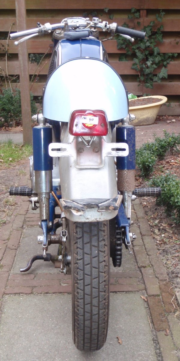

Tail light is standard for early CB's here, added another picture from the rear.

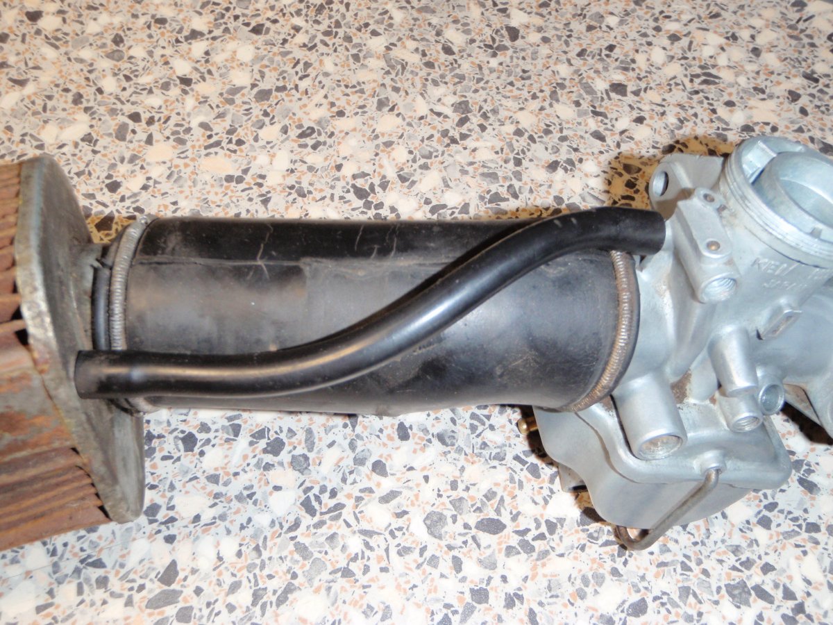

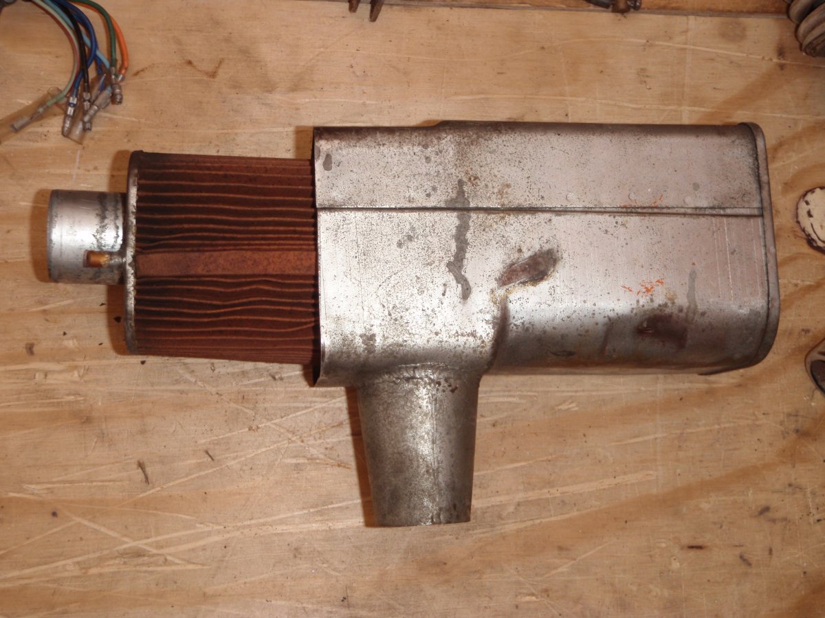

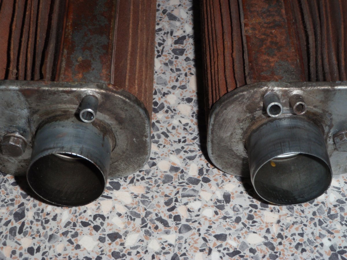

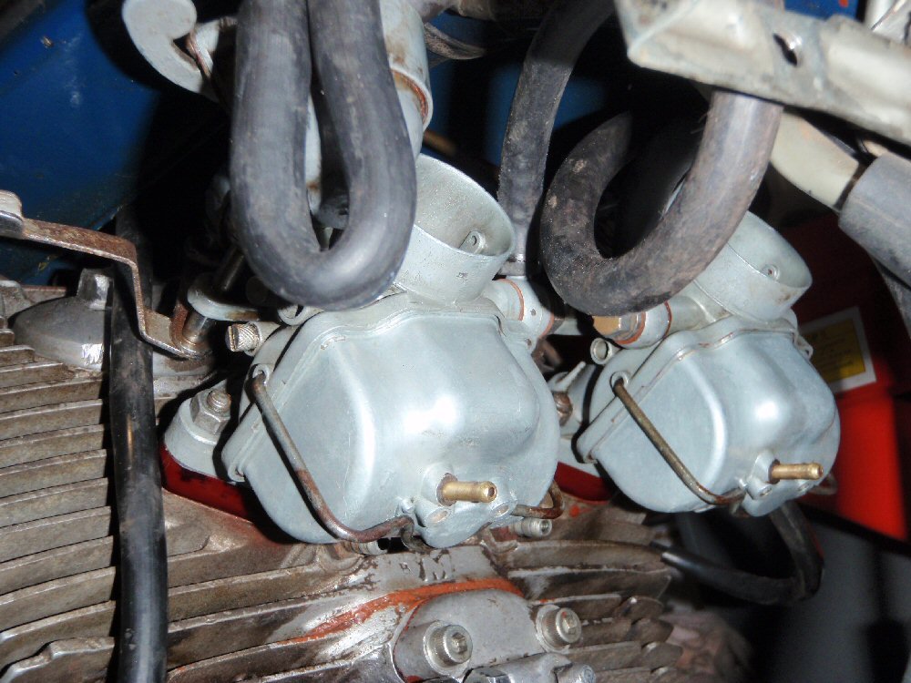

Square bowl's, with power jets, they're clean in the picture, because I cleaned the carbs for a quick run test. It ran, no strange noises, but the engine needs more then a little TLC.

You can interrupt my thread any time! :-) Those pictures are really interesting. My bike has the same rear light and bracket as yours. Alan has the filters for the Power Jet carbs but my bike had no filters at all. It survived for 40 years in the wet on open bell mouths and the engine was perfect inside....

Just one more question. Have you seen the early spring clip style air filter hose connectors anywhere? I have some for the Dream but they are too large for the CB72.

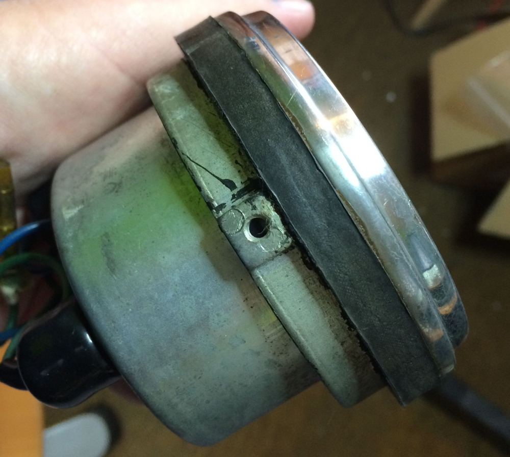

On later speedos where the spring was eliminated, what holds the speedo in place?
Mine is very insecure just sitting in the foam collar.

Depends which year your bike is. On post '63 Bikes there are two screws in the headlamp bucket which screw into two tapped holes in just below the speedo bezel.
On the 1962 type the screws go through the side of the aluminum speedo hoop on the top triple clamp.
