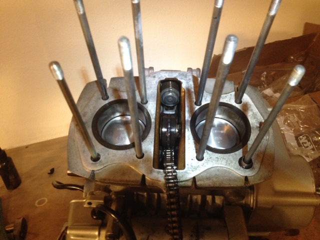

Post by Brickyard » Sun Nov 08, 2015 2:07 am
Pistons slid into cylinders like butter

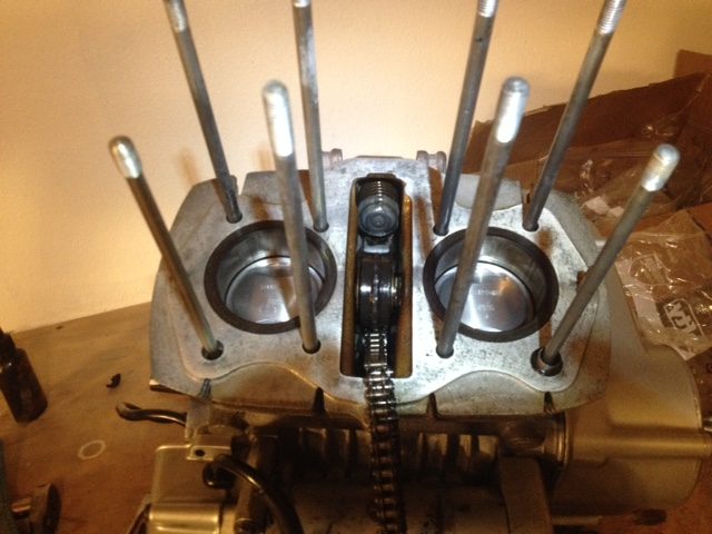

Post by Brickyard » Sun Nov 08, 2015 2:09 am
knock pin and o ring are accounted for. They're in the head.
