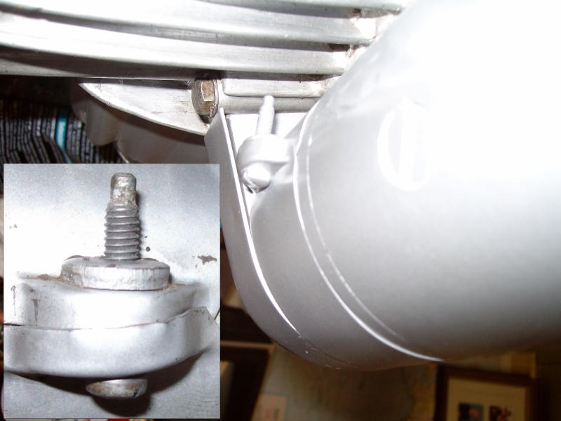

A couple questions I was still wondering if anyone knows the answers:
1. Is it ok to sandblast carbs with aluminum oxide?
2. Does anyone know exactly how the commutator cover goes? Bottom lip on top or under? Is there a washer that you normally have in there? I can't seem to get the screw to stay in.
Post by LOUD MOUSE » Wed Feb 04, 2009 6:44 pm
No on the carbs abnd ya have the cover on up side down and there is a paper sort of seal inside the part and that will show ya where to locate the cover. ...............lm
Spargett wrote:A couple questions I was still wondering if anyone knows the answers:

Thanks Loud Mouse. Yeah, I see what you mean with the paper cover aligning to the open area where the commutator is exposed, and the rubber lining that area to help keep a water tight seal.
I think I'll just order the small washer that is suppose to be there. I don't remember ever seeing one, but Western Hills Honda says they have the 4mm washer in stock for $0.48 (which I'm hoping is true, they didn't have 1/4 of the parts for last order I placed). I'm wondering if this is the key component to holding the cover in place. Otherwise the screw just isn't enough to hold it down. The hole in the lower side isn't threaded, the screw just kinda pokes through and doesn't hold anything down on that end. I prob should have just left it all on.
I guess in a worst case scenario I can try and find a nut small enough to fit underneath it all.

Post by Gunner_CAF » Thu Feb 05, 2009 11:00 pm
Spargett wrote:Thanks Loud Mouse. Yeah, I see what you mean with the paper cover aligning to the open area where the commutator is exposed, and the rubber lining that area to help keep a water tight seal.
I don't know if this will help, but I attached a picture. My starter is on the motor now so its hard to get a good shot. The insert is a close up of my old starter. It is not working and my son just put the parts together, but it gives you a better look.
I am not sure why the head is slipping through. Just use a common washer. I don't know if I would pay a half dollar for a little washer unless it was a big box of them :)
Gunner

Post by Spargett » Fri Feb 06, 2009 7:15 am
Thanks Gunner, that's a huge help. I appreciate you taking the time to do that for me.
Gunner_CAF wrote:I don't know if this will help, but I attached a picture. My starter is on the motor now so its hard to get a good shot. The insert is a close up of my old starter. It is not working and my son just put the parts together, but it gives you a better look.
