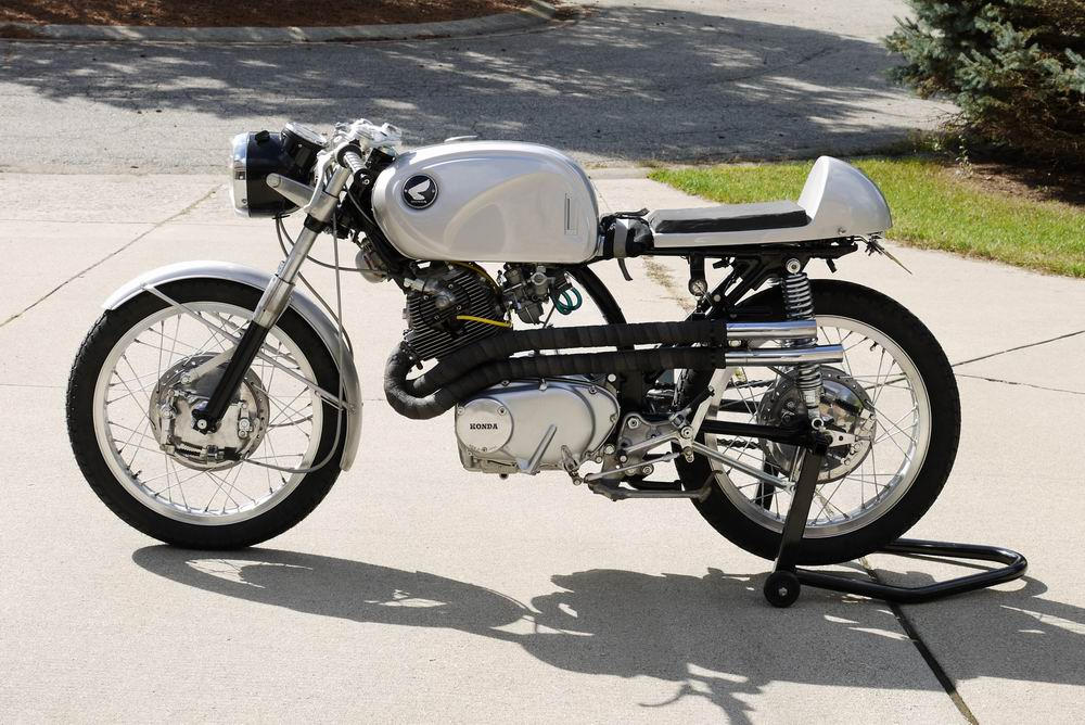

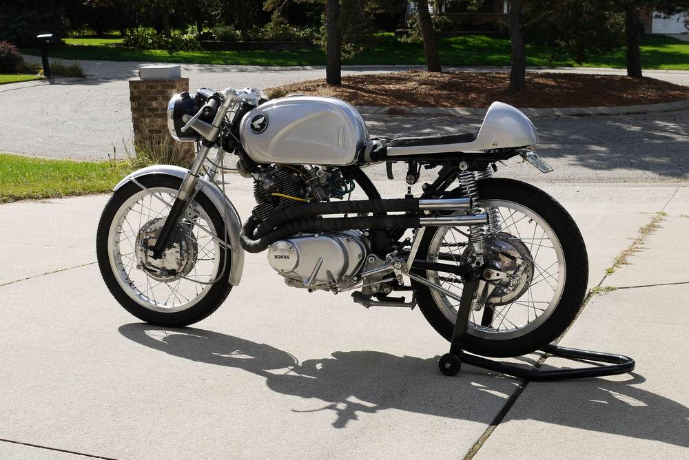

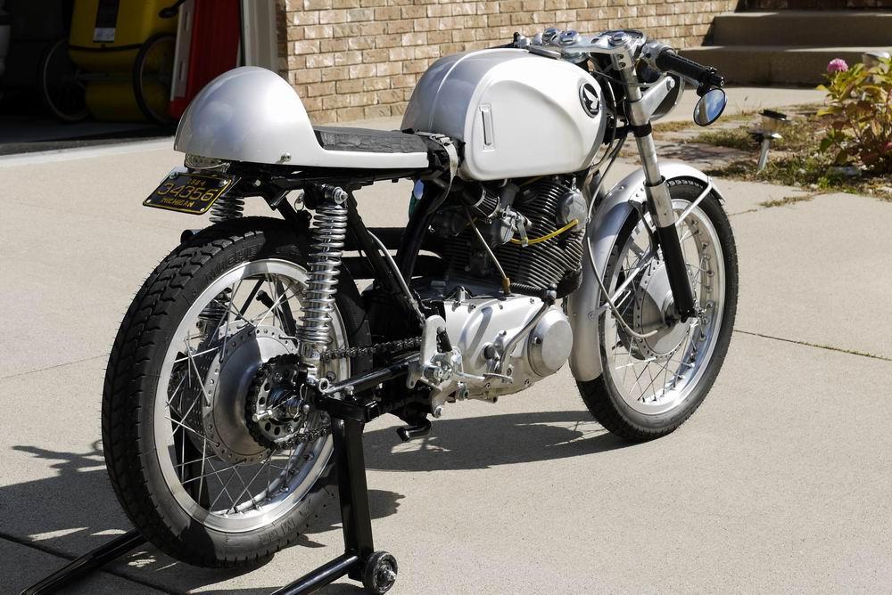

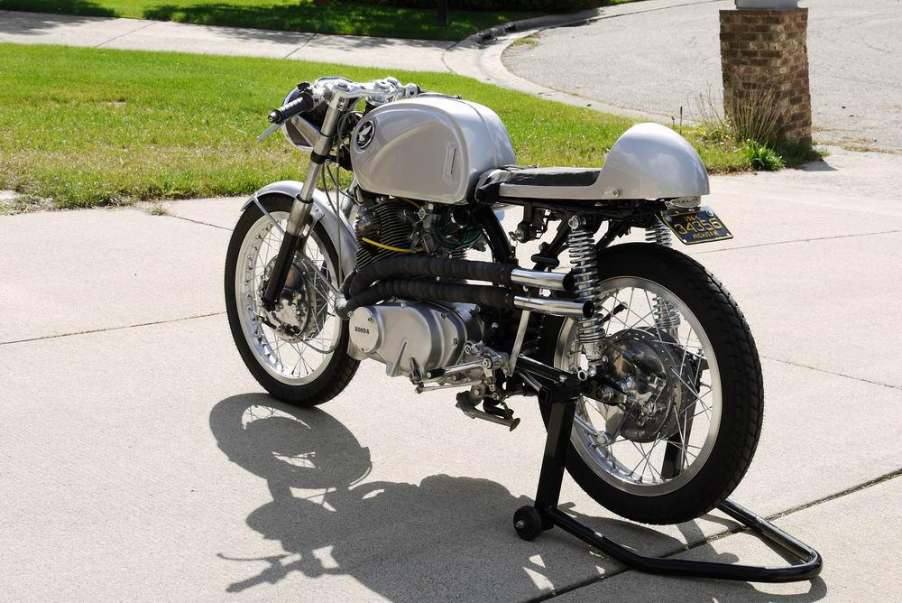

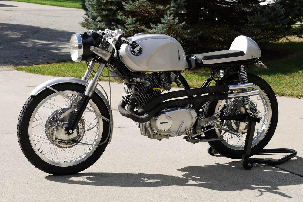

Post by eyhonda » Sun Sep 19, 2010 12:47 pm
New updates:
1. As I posted in another thread, I changed the oem coils to Dyna coils. But I found out later that I didn't connect the ground strap. So, the oem coils were probably OK. Anyway, I get great spark now and she runs awesome. I used yellow suppression wire. That was another thread, but the suppression wire worked ok. I ordered them by accident instead of the copper core type.
2. As I posted also in another thread, I considered changing my CB Dunstall pipes to CL high pipes and centerstand to the kickstand. Well, I like it much better now. It looks better in my eyes as a cafe bike. I also wrapped the headers in black exhaust wrap. Then , I cut off the lower pipe brackets for more clearance, although they are not done in the pics below. Handles awesome now and I don't have to worry about the low pipes and centerstand dragging in tight corners. I like to lean!
3. I had a leak in the tach drive and have since just changed it out. In the original drive, I tried to drill out the retaining screw after I messed it up. I wanted to change out the oil seal. The new one is fine now. I have a slight seepage around the left side of the head still. That's the next oil leak to chase down. But its slight.
4. Lastly, since the last time I posted pics, the seat wasn't done. Now it's painted with a couple of bolts on the side just for looks. I originally wanted to use them for bolting down the seat, but it didn't work. Now, it's cosmetic since I didn't want to repair the resulting holes. The seat pad is just a simple foam pad. I may upholster next time. I just want to ride. It looks a bit rough but kinda gives a raw cafe-racer look.
So, here are some of pics of it's current state. I only have about 200 miles on her and riding season is almost over. Just enjoying the riding!
