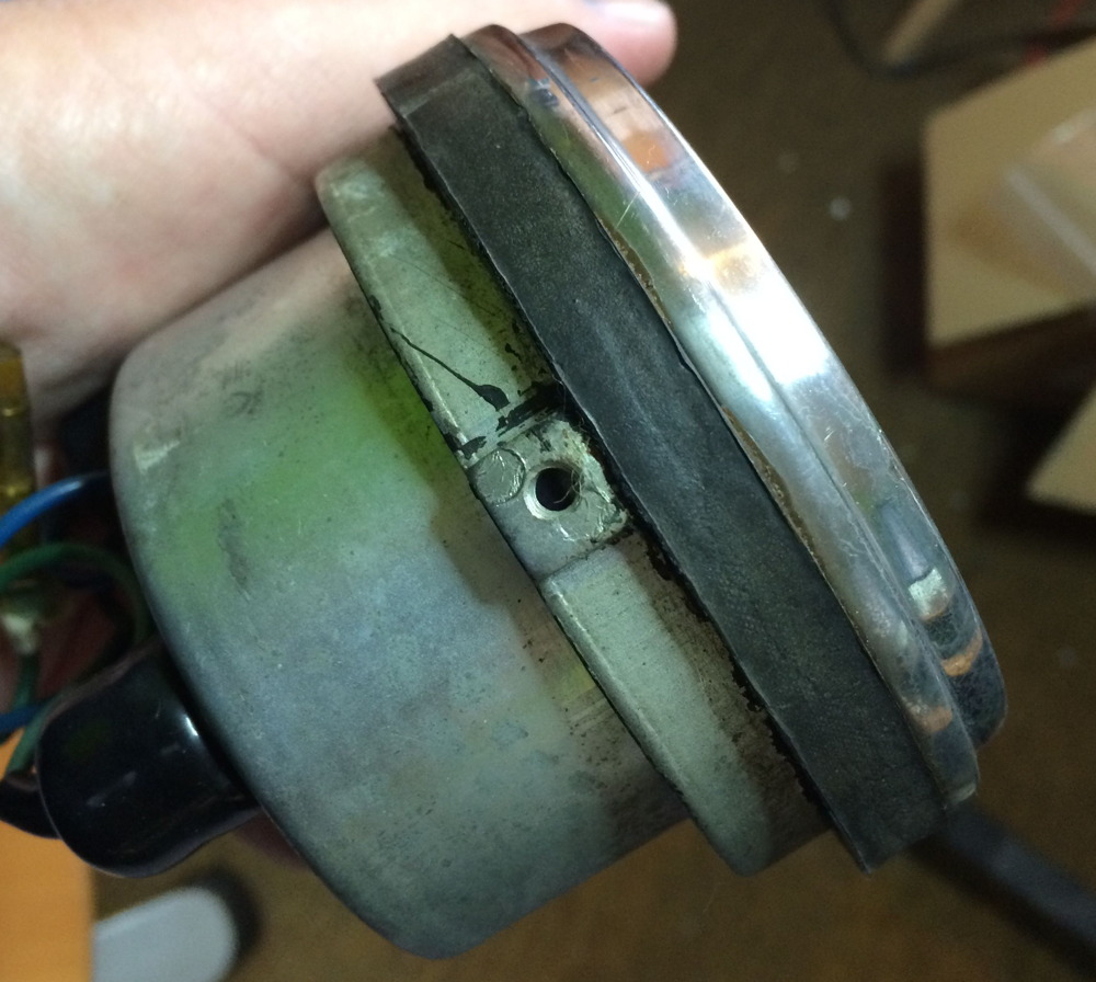

I have what you show in the picture.
Two 6mm long 4mm bolts go through into the metal part of the foam rubber ring around the speedo.
My speedo is not attached to the foam rubber, so the tach and speedo cables push it up when the handlebars are turned.
Is that rubber ring originally attached to the speedo with adhesive?
G-Man wrote:R100
Depends which year your bike is. On post '63 Bikes there are two screws in the headlamp bucket which screw into two tapped holes in just below the speedo bezel.

R100
Yes the speedo is bonded to the rubber.
Here's a replacement if yours is perished.
http://www.ebay.com/itm/Honda-CB77-CB72 ... 29&vxp=mtr

Post by R100 » Mon Oct 06, 2014 10:53 am
Thanks.
Mine is actually in reasonably good condition, but no longer bonded.
First I will try and re-glue it.
Perhaps 3M weatherstrip adhesive.

R100
I would be interested to know how that turns out.

Post by cknight » Mon Oct 06, 2014 12:00 pm
The 3M weatherstrip adhesive will do fine, but can be a bit messy. Lately, I've been using the Permatex black RTV silicone. It holds the ring in place, and it's easier to deal with if you ever have to remove the mounting ring. Regards, Chase
