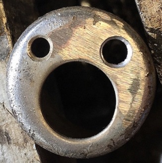

First up are the little tab washers that lock the brake stay bolts. My original brake stay was drilled near the bolt holes and the tab washers have a little dimple punched into them to locate with that.
I drilled some holes (1/16") and then used a masonry nail to punch the holes into the hole in a spare stay. I'm not sure why these holes are there as the part has little 'wings' that locate around the brake stay. They got deleted later on nut I wanted those little holes to be evident on this bike.
You can hardly notice when the stay is on the bike, but I feel better about it now.... :-)

Post by e3steve » Sun Aug 20, 2017 4:43 am
Graham, your attention-to-detail just makes me want to say....

e3steve wrote:Graham, your attention-to-detail just makes me want to say....

Post by G-Man » Sun Aug 20, 2017 12:30 pm
Steve
Thanks! :-)
