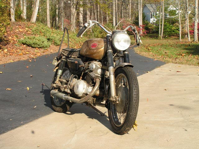

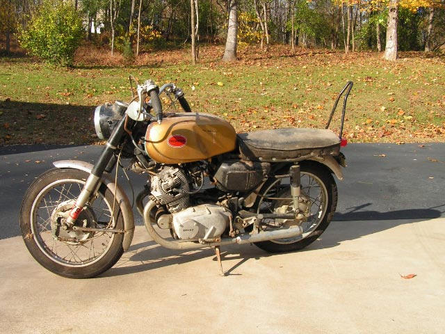

As I posted in the introduction thread under Superhawk I have acquired a 1962 CB77 which needs a lot of work. It was last regestered in 1981 and I don't know if it was used off road after that. It has been in a shed since at least 1983.
From time to time I will post progress and pictures.
Here is what it looks like now.
Larry

The bike looks very cool the way it is! Are you planning to bring it back into stock ?
Do you know which bike the fuel tank and side covers are from?

I'm not sure if I will bring it back to stock or not. I think I will get close.
The tank may be from a Goose but the previous owner and I arn't really sure. The handle bars are not stock and don't really fit the holders, they are to narrow between up sweeps jaming the holders. The wireing as been modified but I should have the factory harness in the box of goodies that came with the bike.
Side covers are any ones guess.
I have just removed the plugs and poured some mmo in the cylinders and turned it over slowly with the kick starter. It Moves, a good sign.

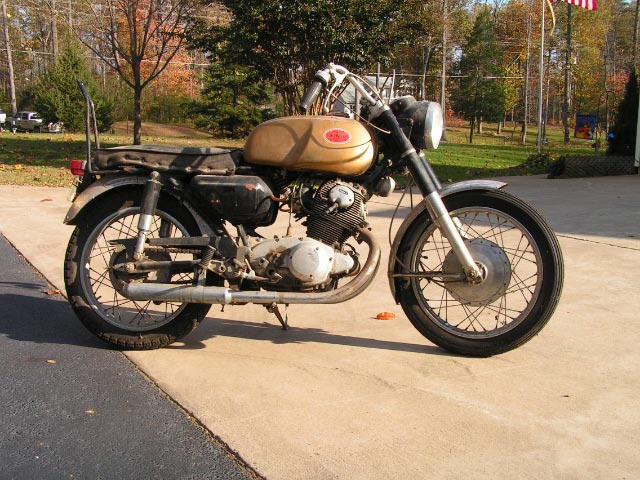

Looks like a great starting point. I'd do the major engine adjustments and services and fire it up as is before going crazy looking for missing parts. At least you can use it as you figure out what to do with it.
Post a picture of the tank and side covers. They look Italian (and familiar) to me, and if so, are probably valuable.

The tank is said to be a Moto Guzzi, correction we think the tank is a Ducati. There are petcocks on each side of the tank.
Also the kick start lever does not look anything like the fiche so I am not sure it is standard either.
The bike was said to have been used to herd cows in Vermont and the person that gave me the bike said he received it in peices. I do know the frame and engine numbers are correct for the Superhawk.

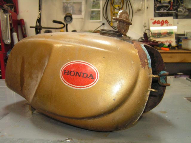

Gas tank. Note filler. Twist lock and flip open front. Tank appears tight with surface rust inside.

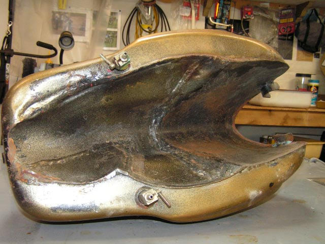

Note the 2 petcocks.  They look original.

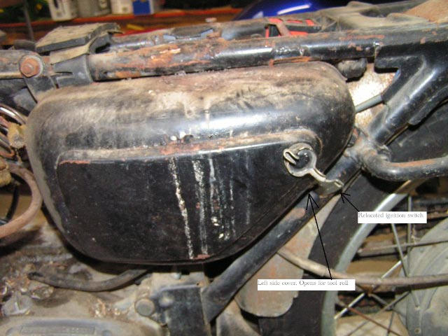

Left side cover. Opens for tool storage. Ignition key has been relocated to rear edge of cover. This cover does not appear to be stock.

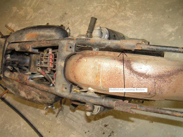

Note the modified seat mounting brackets. They appear to be extended to allow the non stock tank.

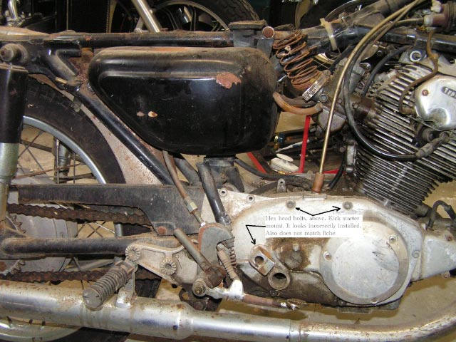

Note the kick starter mounting pivot.  It does not match what I see in fiche. <br />Also note the hex head bolts for the cover mount. Any bets on 1/4-20?
