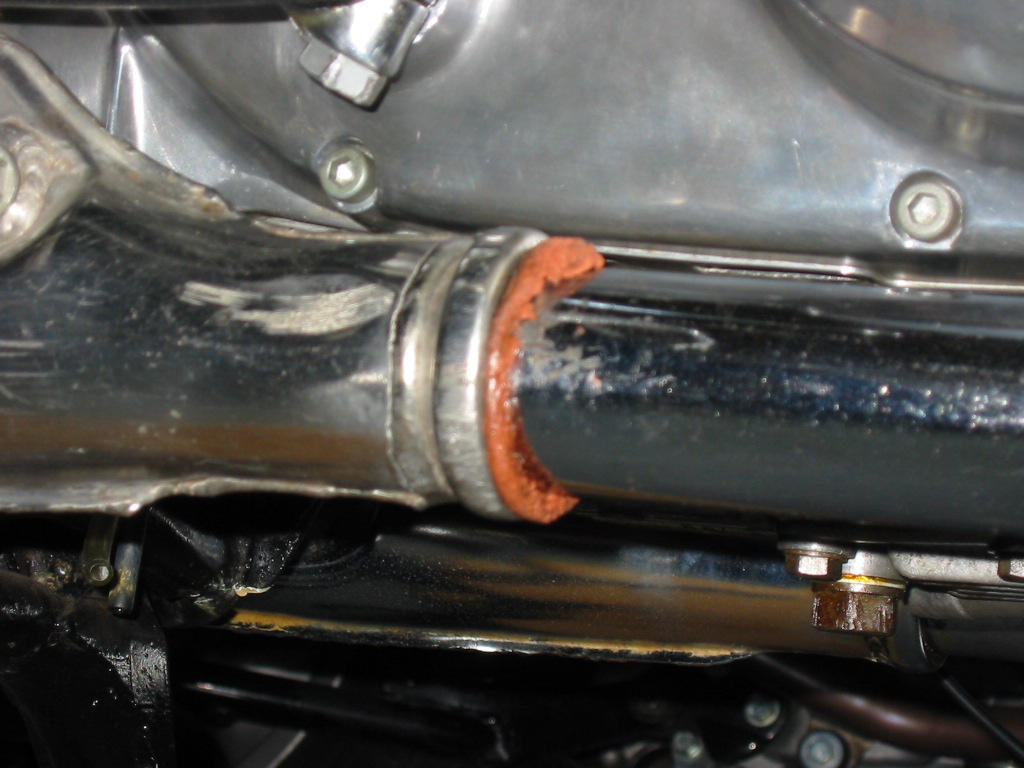

Just a side note that might be relevant. I recently purchased a set of muffler seals for my CB77 off EBay, and they immediately melted when I started the motor. The EBay seller kindly refunded my money. Did you perhaps buy some of the same seals?
Melted Exhaust Seal
Melted Exhaust Seal
Not from hdhummer, by any chance? I've always had good service and products from them, but not tried the seals yet -- they're for the rebuild.
chico
Posts: 134
hdhummers
Post by chico » Mon Sep 21, 2009 7:59 am
Yes my rubber on the left side looks just like dkwilfert's, and they are hdhummers.I would like to see some pics, steve, where's your thread on the the forum? Don't forget to include your brite and shining face.
