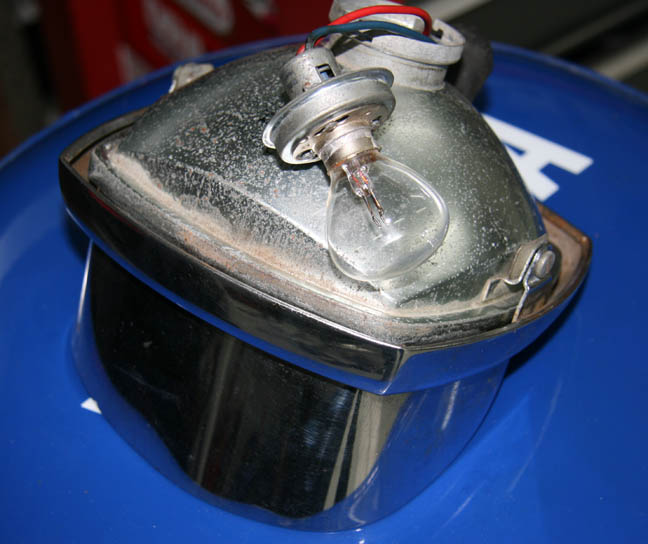

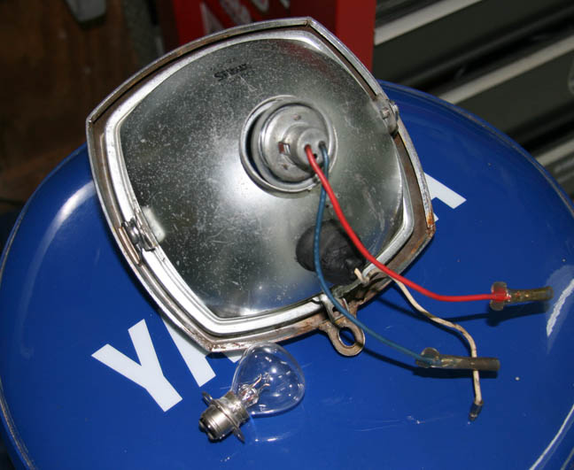

Alamo, California to be precise. Here's a pic of the light housing. It's stamped Stanley 60194 12V 35/30W.
The bulb fitting is bayonet-like. What you see there is a 6 volt bulb from my CA95. It fits perfect but wrong voltage of course. Thanks!
CA77 housing
CA77 housing
CA77 housing
CA77 housing

Thanks guys for the quick replies. Fred, I'm just not sure what you have would fit. I think what the previous owner did, he took the bayonet fitting from an old bulb and fitted it to a regular bulb. I might give that a try.
I had a similar situation with my CA95 and lucked out one day with a guy in the Mojave Desert who had eight of the bulbs. I think the diode idea might just be the way to go. I still would rather have the proper bulb.
