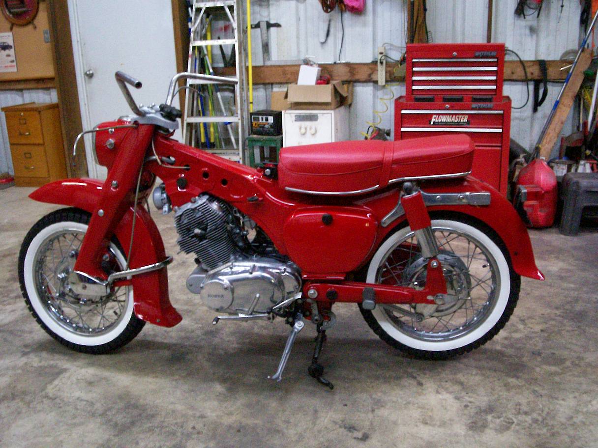

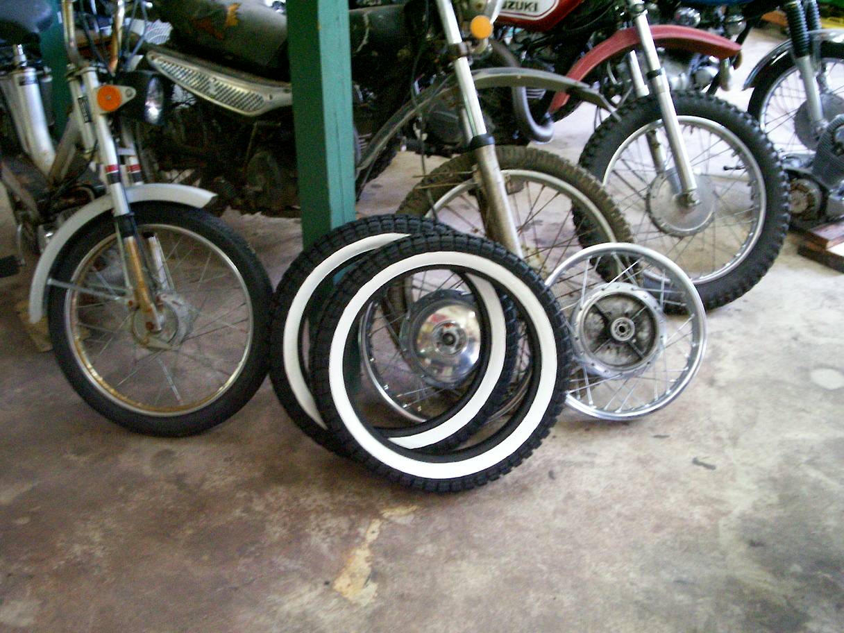

I polished all the covers on the engine and the center hubs on both wheels with 0000 steel wool from wal-mart to a mirror like shine and as for the tires I had good blackwall tires on the bike with the vintage tread design so I ordered FONZIES whitewall paint and put 4 coats on each side letting each coat dry for 24 hrs before the next coat. it does a fine job and I have washed greasy fingerprints off the whitewall with mild soap and water and it did not affect the whitewall paint. the paint is rubber in a liquid form and only $23 for a quart I still have enough left to do about 8 more tires.
