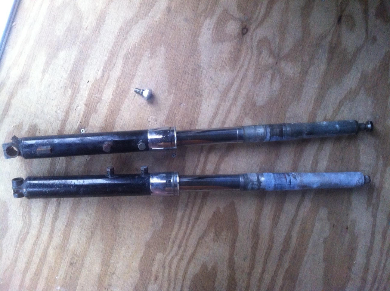

I am beginning a restoration on a 66 cl 77 and I have come to my first road block. What is the procedure to disassemble the front fork? Specifically removal of the Chrome front fork seal housing. I know the "c" clip or retainer needs to come off so you can get to the seal. I am including a picture to better describe my issue. It looks like there are 3 or 4 notches around the housing. Is this for a special tool to help in removing them. Thanks in advance.

unscrew the seal holders
Post by FAST FRED » Mon Oct 08, 2012 1:28 pm
The chrome seal holders unscrew from the steel lower forklegs and than the fork tube can be pulled apart.

Thanks. Is that what the notches in the chrome seal holders are for? To help grab a hold and unscrew? Do you have any suggestions on unscrewing them?

You need a pin wrench
Post by FAST FRED » Mon Oct 08, 2012 1:54 pm
Sometimes these seal holders are a real pain to remove after years of being screwed onto the lower leg. Yes the holes are there to grab with a special pin wrench. Most people use a rubber strap wrench to avoid damageing the holes or the chrome .

Post by G-Man » Mon Oct 08, 2012 1:55 pm
Mitch
This is my home-made tool for unscrewing the holders...

Post by nosfoursale » Mon Oct 08, 2012 2:52 pm
Thanks guys:
You have been a big help. I will try the strap wrench trick first. If that doesn't work I guess I'll have to fabricate a tool.

Post by Snakeoil » Tue Oct 09, 2012 9:56 am
Don't be afraid to use a little heat. I assume you'll be repainting the lower sliders and you won't hurt the chrome with heat. I forget which bike it was, probably my S90, but I had to use heat to get those off. I also used a strap wrench. I've since made a pin spanner, but with only two adjustable pins, not 4 like G-mans. Nice job on that, by the way, G-man.
If you use a strap wrench, you might want to get yourself some rosin. I have a container from gunsmithing days. You use it with hardwood jaws to uncrew barrels without marring them. Your chrome looks pitted, so you might have sufficient grip. But if your strapwrench slips, try some rosin. Not sure where you buy it in stores. Maybe a hardware store or sports shop. Rosin bags were used to give you a better grip on a bat in baseball when I was a kid. But I don't know if they still use them. I got mine from a gunsmith supply house called Brownell's. They are on-line and have lots of neat specialty tools that are handy for bikes as well.
