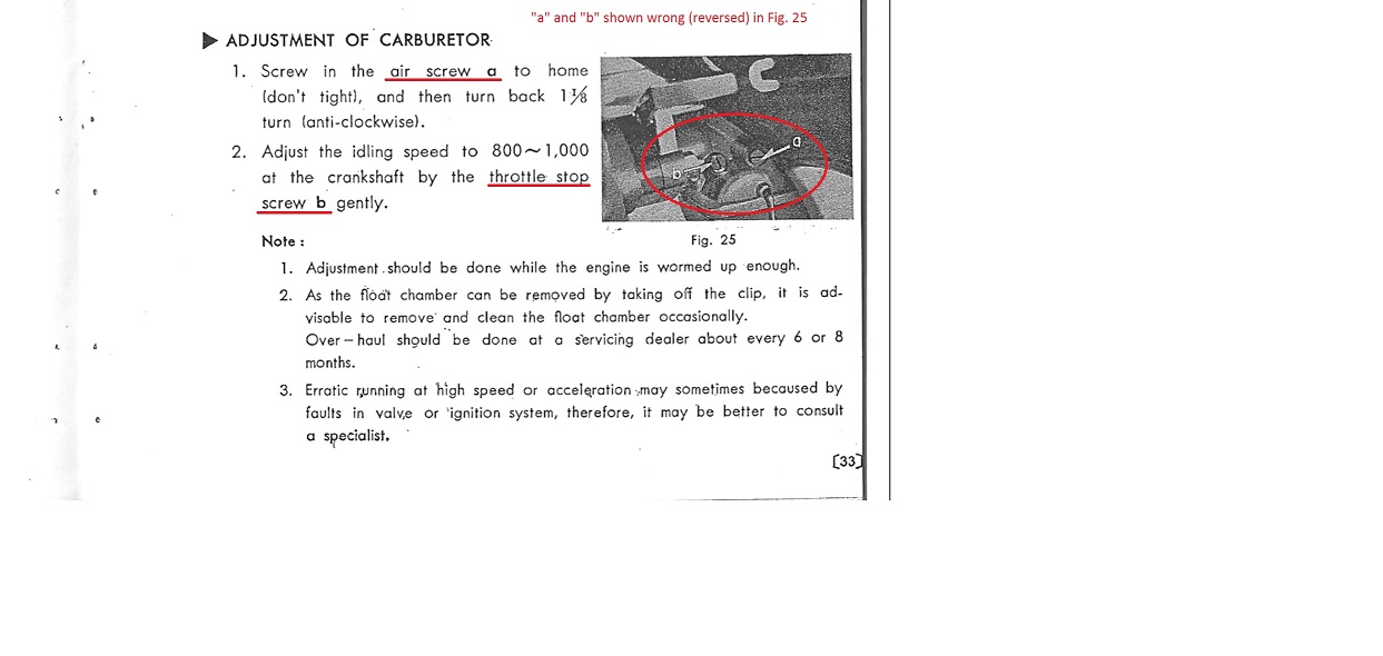

Note the Carb screws for adjusting idle mix and idle speed are shown incorrectly in the 1965 version of the Owners Manual.
They are shown reversed in the attached figure:
CA77 Carb Adjustmrnt Screw Mistake1.jpg (63.17 KiB) Viewed 17061 times
