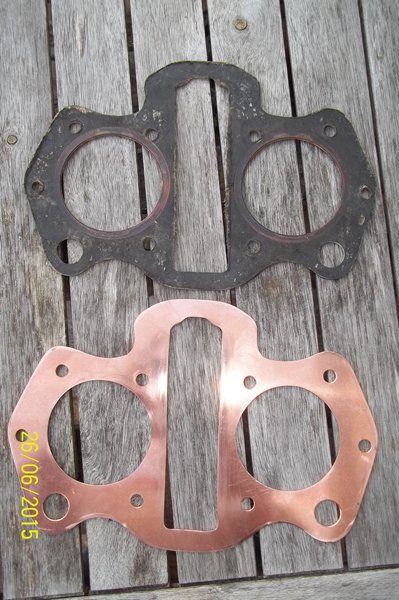

I made one up myself....made a template up and cut it out of a copper sheet.
