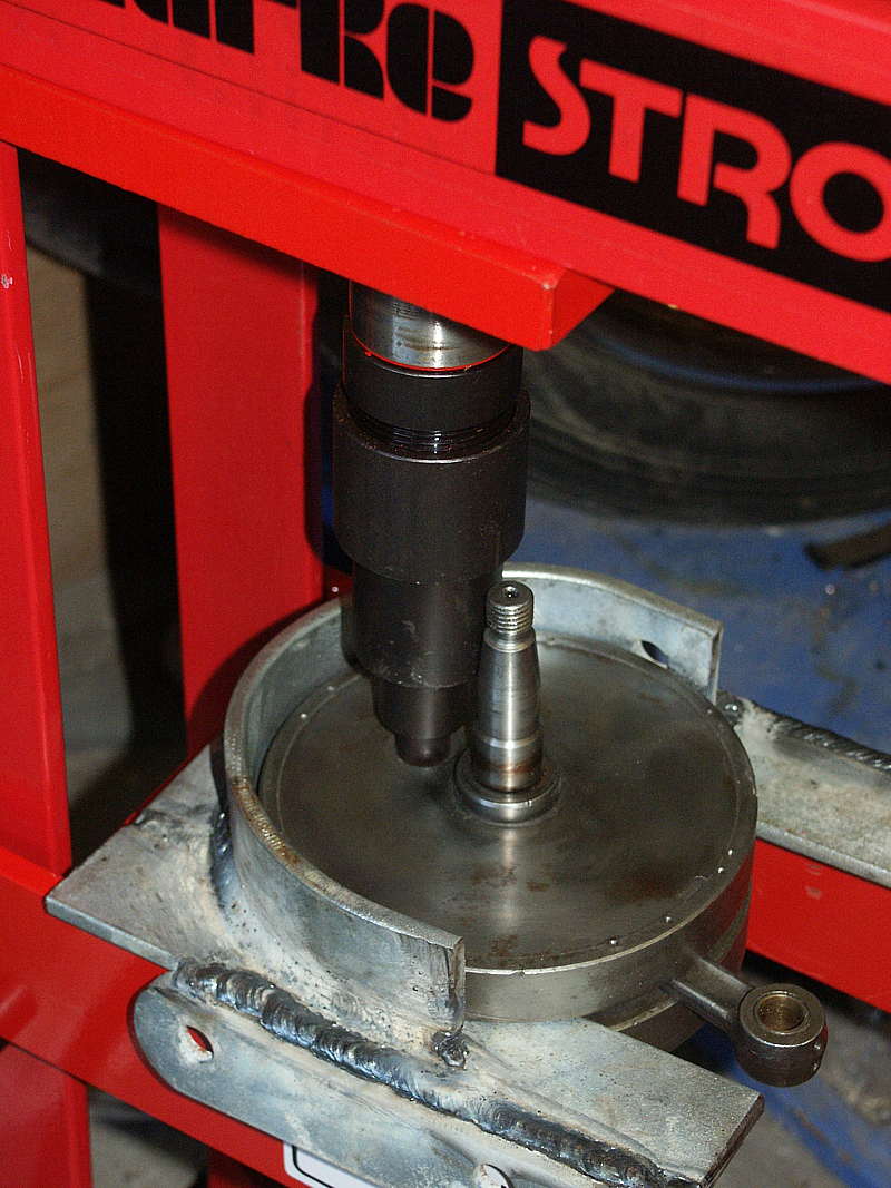

I dismantled a BSA Bantam crank using my 10 ton press at home and the press was creaking a little when the crankpin finally started to move. I had to build a special jig so that I could hold the crank securely in the press.
How are you supporting the crank in the press? It may be that 12 tons is not enough for these cranks or that (perhaps) you are pushing against the wrong surface.

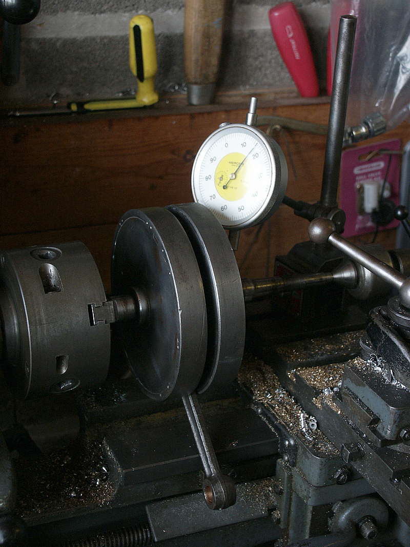

For rough alignment, you can scribe a line across the crank webs before dismantling. and then line it up again on re-assembly. For final alignment you will require V-blocks a dial gauge and a big lead hammer.

Truing the crank after assembly

Pressing the pin out using a home made support jig

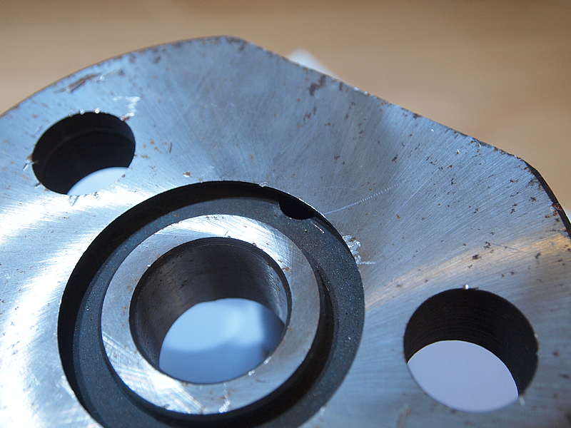

The 'lead' you were looking at is, I believe, an aluminum plug which blocks off the oilway drilled through the crank pin. It breaks through into an annular groove in the other side of the web, providing an oilway to the big end.
As you can see, the pin is parallel so the 'plug' does not interfere with the dismantling process.
Incidentally, you can use those holes to roughly align the crank at reassembly time.
