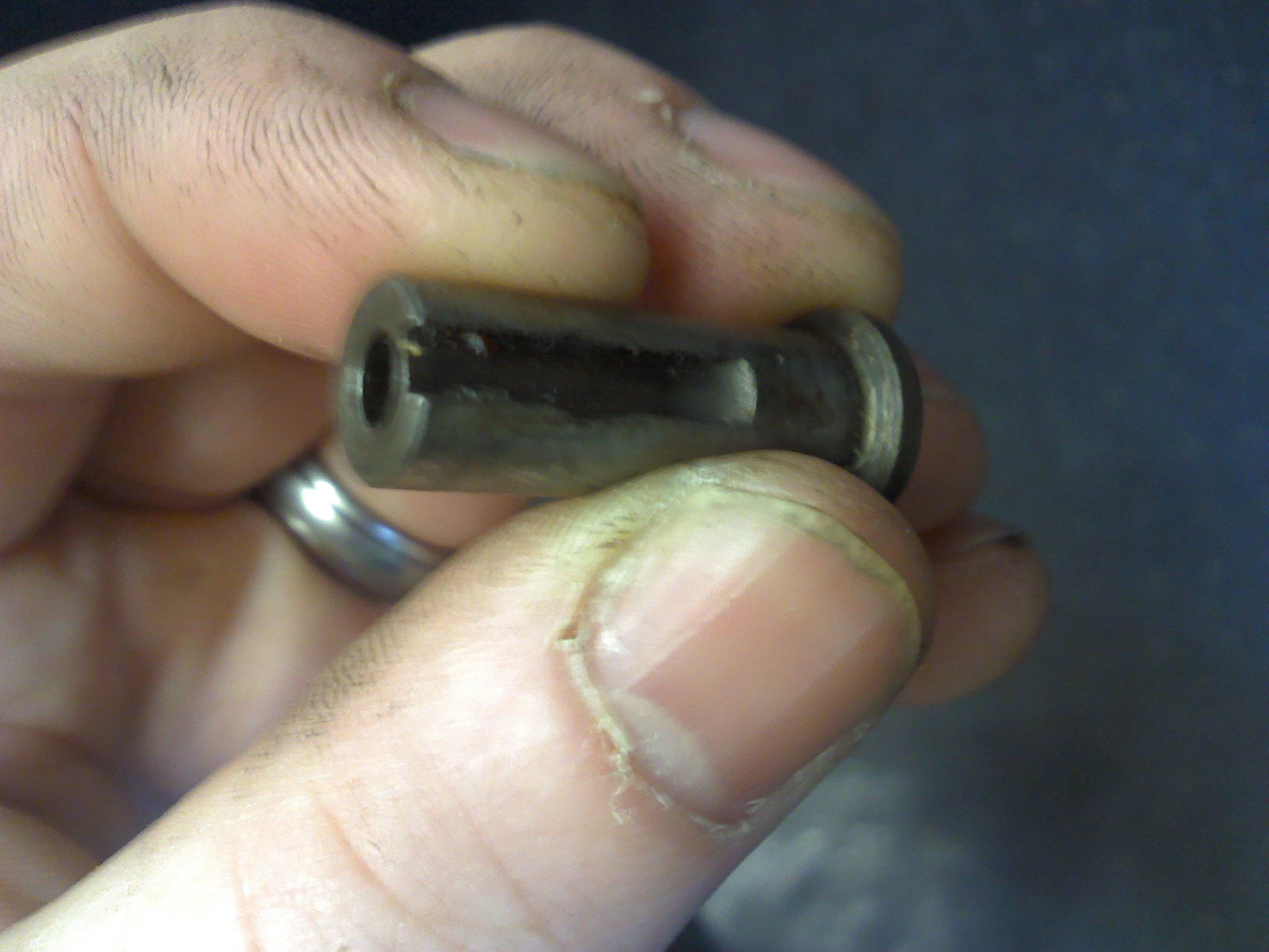

I have a 67 CL77 that is my first project, let alone my first motorcycle. I took the head apart to replace the gaskets and piston rings, then put it back together. While mounting the engine, I found this part, and can't figure out what it goes to. The engine is back together, so I'm hoping this is easy to put back on without tearing it back down. Any advice would be very helpful.

Did you take apart the clutch? That looks like the piece that mounts to the outside of the clutch assembly at the end of the clutch release shaft.

I didn't take apart the clutch
We left that crankcase intact, but we did take the clutch cover off to replace some oil seals. Could it have come off without taking the clutch apart?
I've already gasketed and closed the clutch cover back on the crankcase, but I have not filled it with oil yet. Can I take that cover off and reuse the gasket?

look here......
http://www.cmsnl.com/honda-cb77-super-h ... E++06.html
That part sits in the middle of the clutch......it's spring loaded somehow too.....can't exactly remember.......but check for the spring too
Yeah, the gasket will be fine

Yup. He's got part # 13 in his hand. Spring is (or should be) inside the shaft that runs through the middle of the clutch assembly.
68Cb77 wrote:look here......
