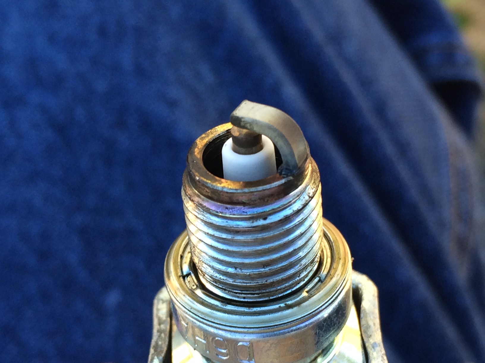

New D6's with 20 minutes of run time. Could I get some opinions on jetting and timing? My wife started calling me the Spark Plug Whisperer. Nice, huh.
pkug chop.JPG (507.73 KiB) Viewed 2944 times

Way on the lean side. The first plugs looked a little pink from heat. In all my 35 years of bikes, street and race I have found that plugs tell a good story of what is going on. You need to richen up a tad. I would rather be a little on the rich (COOL) side instead of lean. Lean is HOT!

G; D6'S are pretty hot for a dream. risky business. your pics of the 8's looked pretty good, I would stick with that and look elsewhere for trouble.
Good luck
Randy

Post by garncarz » Tue Jul 08, 2014 6:34 am
G-Man wrote:They look pretty good, although 2911 looks the weaker of the two....
Have you tried putting the choke on a little when it appears to lose power?
Yes, and it runs better with some choke. What does that indicate?
Posts: 5681
Post by G-Man » Tue Jul 08, 2014 10:49 am
Too lean.
You need to try a bigger main jet.
