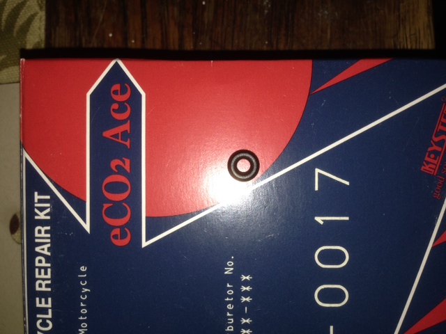

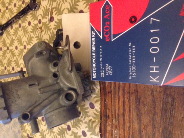

Hello,
I just got my carb rebuild kit and I have this rubber black o-ring, but am unsure where it goes. Any help is appreciated.
Thanks

I believe that is the one that goes on the air mixture screw. One of the screws in the kit has a groove in it. This oring should be in that groove.

Yep, must be the ring for the air screw.
It also makes sense if you think about it :)
