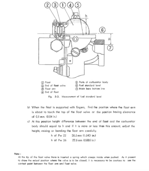

I have a Honda Ca77 305. I checked the float seems to move freely. not sure if it set at the right height though I cant find the specs on float height and I don't know how to measure it. this is a whole new concept for me to learn
Posts: 5681
Post by G-Man » Sun Feb 15, 2015 2:38 am
Here's the page from the manual.
Screen Shot 2015-02-15 at 07.37.03.png (130.36 KiB) Viewed 2716 times

perfect thank you I will be doing this today and see how it goes. thank you ad ill let you know how it goes
