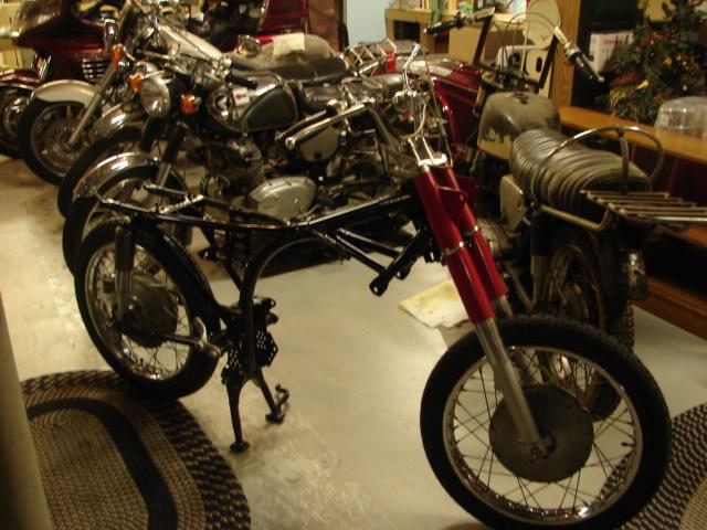

Yeah, those carbs were worth thousands, but my wife "casually" mentioned that she couldnt walk through the basement, and hinted (in a soft but very direct manner) that I should not buy any more bikes, and my health would improve if I cleaned things up and got rid of a lot of "stuff." If you need any more parts, I probably can help out. Looks like the top end on the engine should be usable also ( if I can get it apart) (Shameless self promotion: see my ad in the classifieds. Help reduce husband abuse in the motorcycle community.)
Like I said before. Hang in there. My son still reminds me about swapping the R75/5 for an RD 400 because it wouldn't start when warm, when all it needed was the exhaust valve clearance opened up about 0.001. We both miss that bike.
