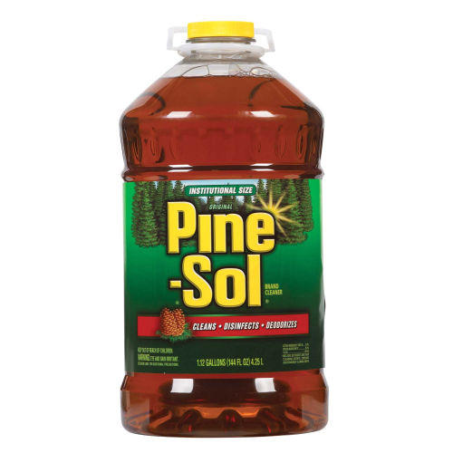

G,
Its a very common household cleaner available at any supermarket in the US and has been around for many years.
It is based on pine oil and has a distinct pine tree smell.
http://en.wikipedia.org/wiki/Pine-Sol
It appears to work as well as vinegar, but not quite as fast.
With its cost being more than vinegar, I can't really see any advantage to using it other than it smells better.

Interesting that the Pine Sol had different effects on different parts.
Note the main jet holder, pilot jet, float pin and idle speed screw came out shiney, while the main jet and idle air screw did not.
Also, the petcock lever and pinwheel spring looked like they had received some pot metal deposits from the process.
When I removed the parts from the solution, the pot metal parts were covered with a slick, thick slime (try saying that fast three times in a row!) the same color as the metal. Leading me to believe some of the base metal may have been dissolved?
At any rate, I think I will stick to the vinegar.
