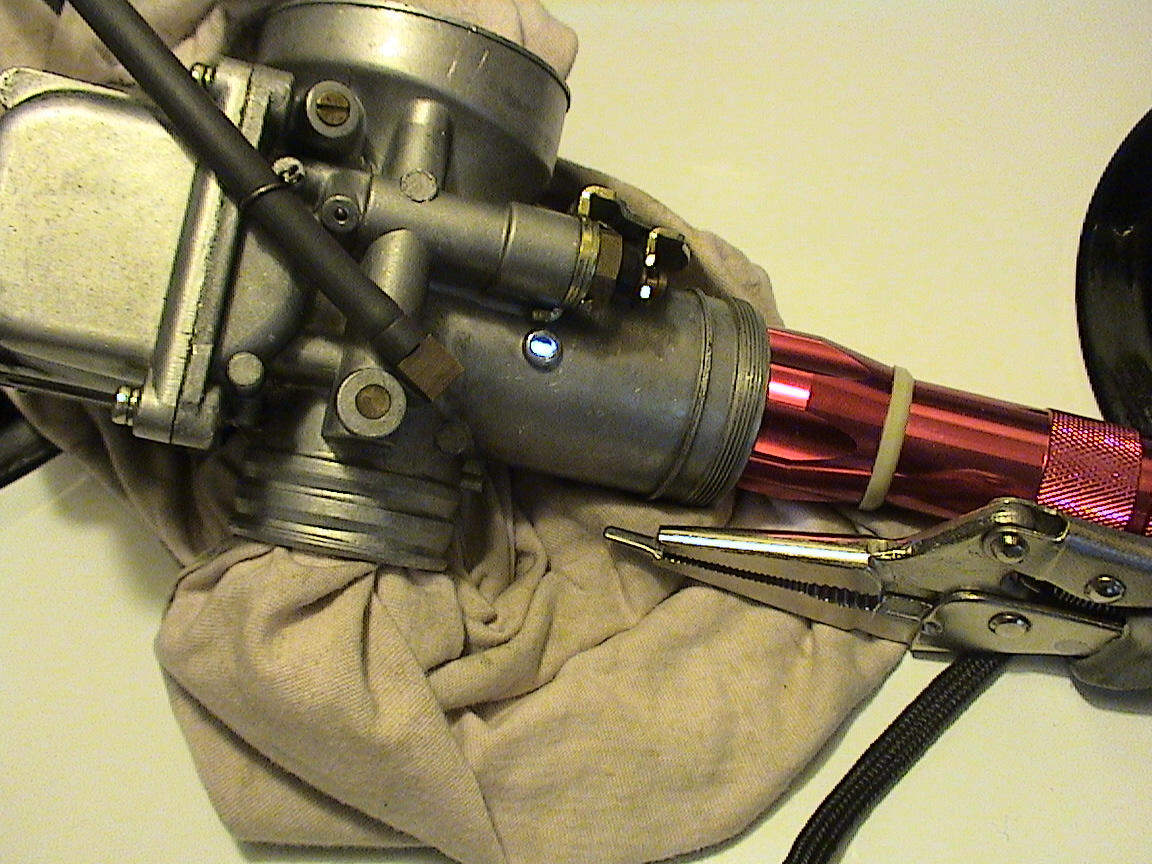

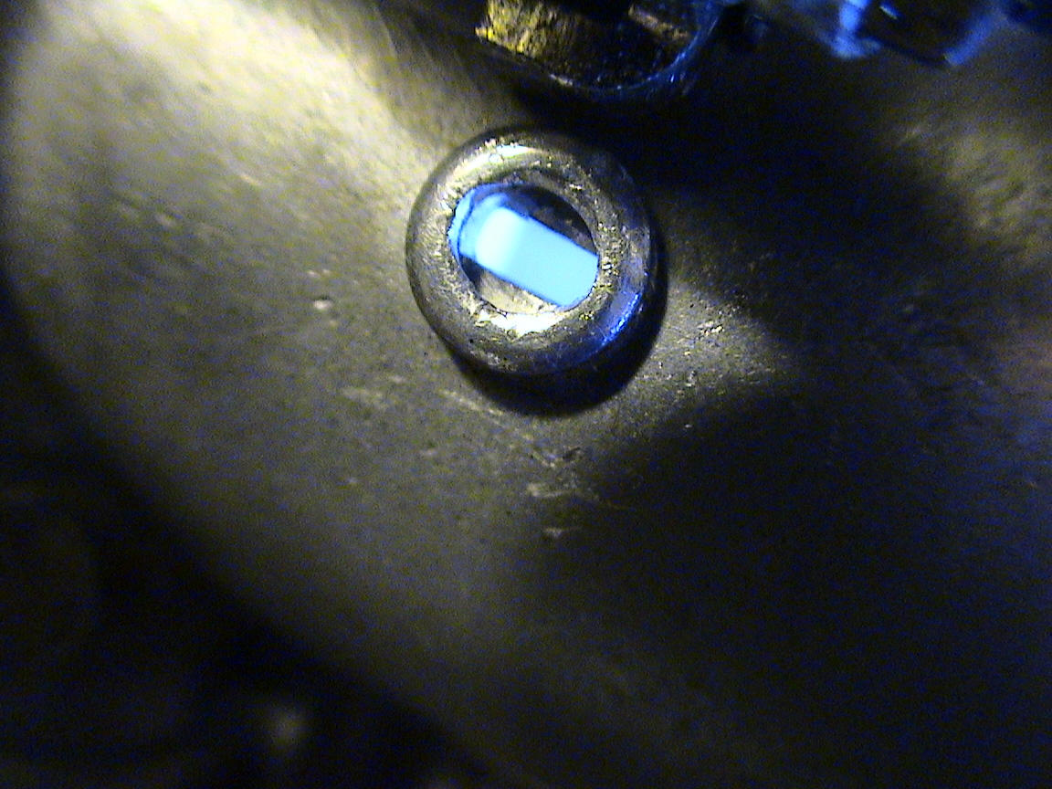

Drilled and pryed out the old plastic, but left the rectangular hole into the slide bore.
Tried to find the right size plastic, but couldn't get the fit I wanted, so I went with a scrap piece of metal from some kind of clamp.
Whacked it to rough (rectangular) size with a chisel and went to the grinder and wire wheel.
Ground down to a snug fit, smoothed it up and JB'd it into the hole.
At first I worried about possible rust problems, but since it is a pre-mix bike I don't think it will be a problem.

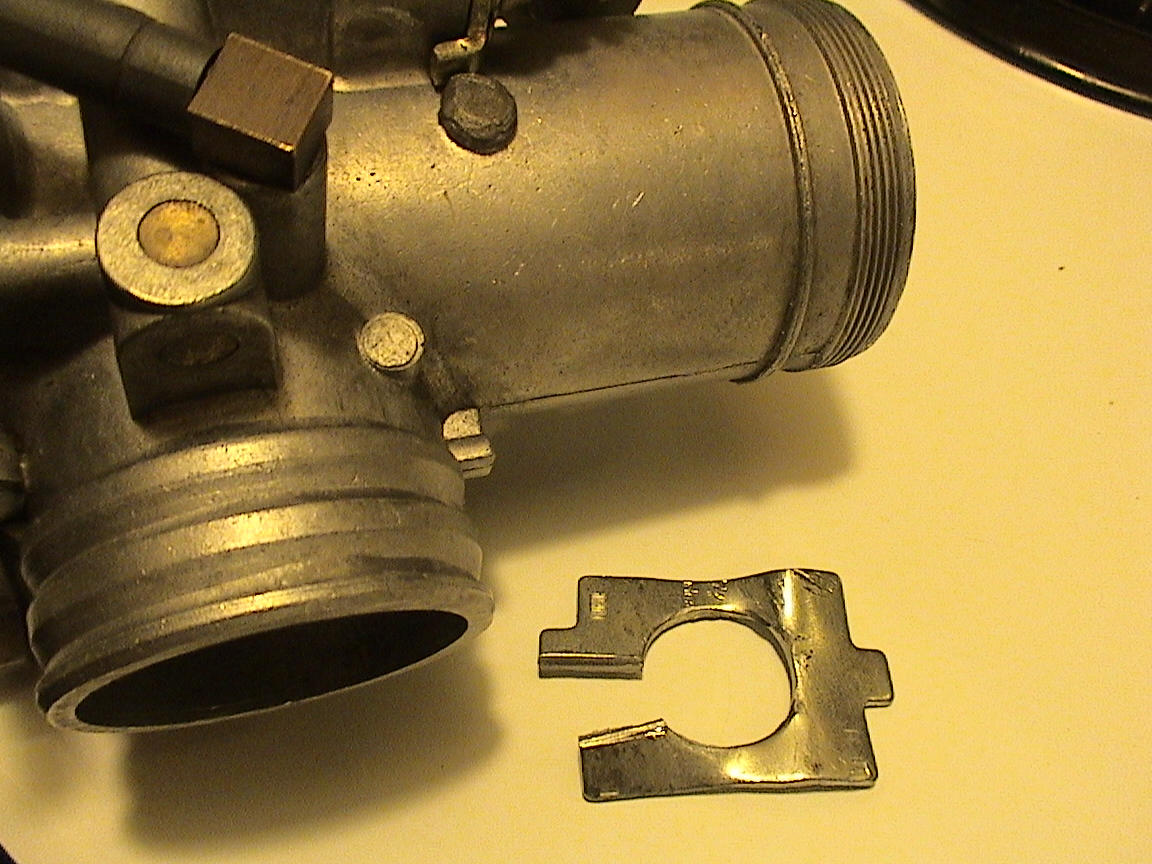

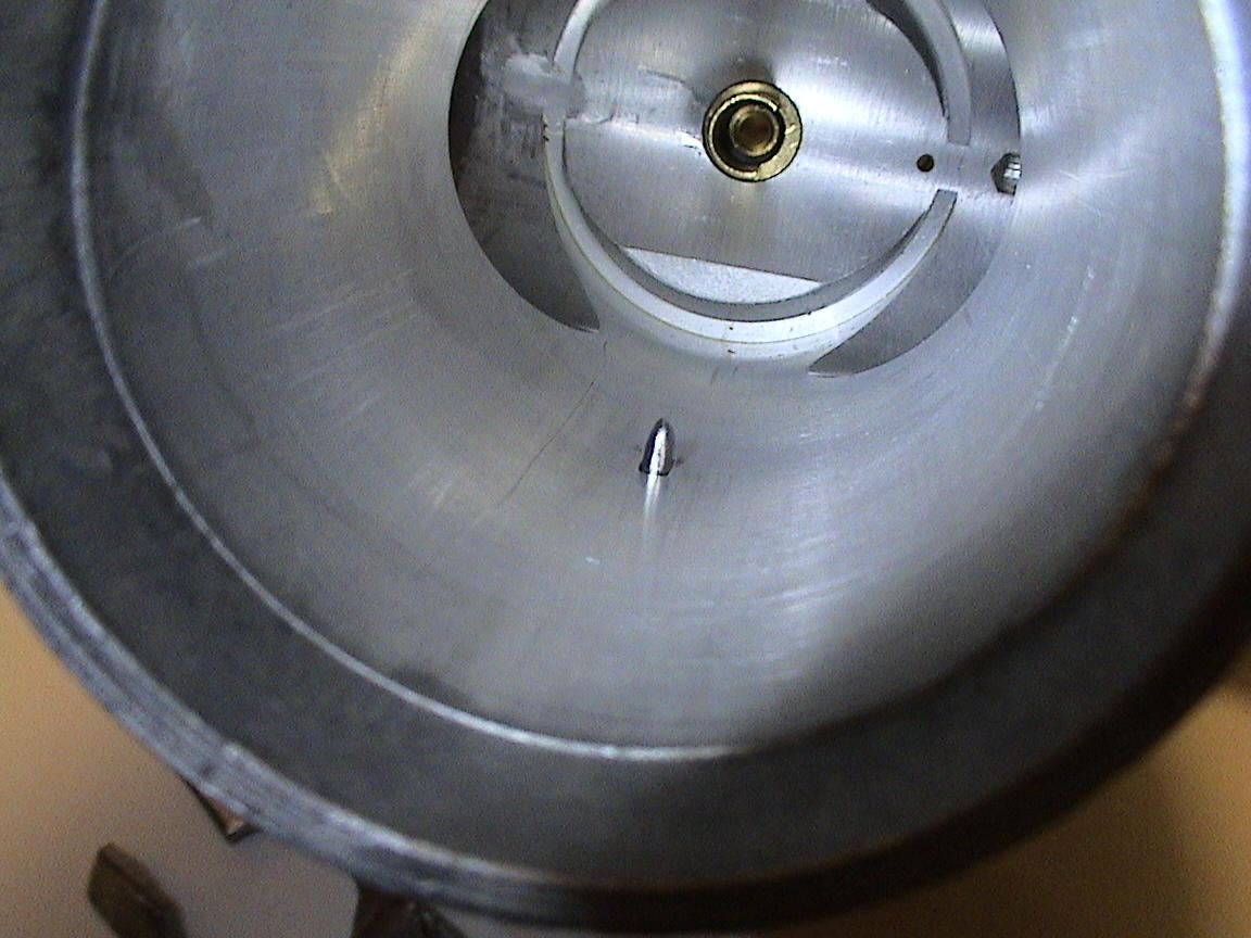

I believe the failure in this case was someone trying to force the slide in without lining it up with the guide...probably with a hammer! The plastic slide guide was sheared off with just a small piece remaining at the bottom.
The slide would hang up on the remaining piece of guide whenever the slide would try to rotate.
The clip was forced off the needle by the needle jamming to the side of the needle jet as there was scaring of the carb body right beside the needle jet that matched where the needle would hit if off center.
