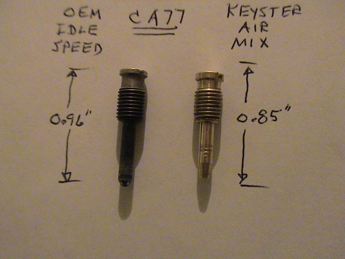

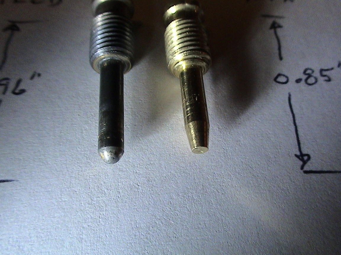

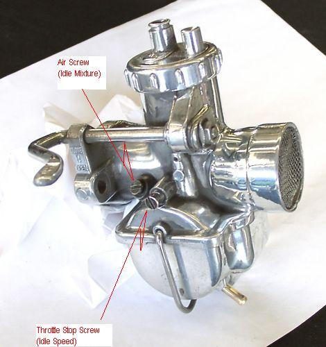

Can someone here post pics of which screw is which on a CA77 carb?
Post by brewsky » Wed Feb 29, 2012 5:20 am
Here are the 2 compared:
The one with the chopped off end is the idle air screw and goes in the front (engine side) of the carb. Some versions have an o-ring, and some don't.
The rounded one is the idle speed screw that adjusts where the slide stops. It goes in the hole toward the rear.
