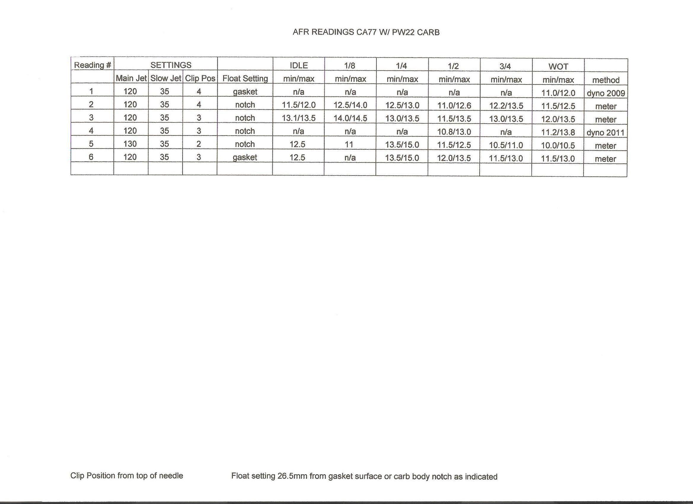

Post by brewsky » Sat Jul 16, 2011 6:04 pm
Two more runs today...
tried a 130 main (didn't have a 125 avail) with needle lowered (2nd notch from top).....too rich at 3/4 and WOT.
Runs best at 120 main, mid needle position.
Tried both float levels, with the higher fuel level showing leaner mix by 0.5 at 1/4 and 1/2 throttle,
and richer mix by 0.5 at 3/4 and WOT. ????????
Will attach a spreadsheet of all runs when I figure out how....
Post by brewsky » Sun Jul 17, 2011 4:31 pm
Spreadsheet attached.....
Learned a few things in the process....like how much the needle position affects the WOT ratio, at least on this carb. Also, a couple mm in float height difference can affect A/F by about 0.5 one way or another at different throttle positions.
Also the 130 main included in my Keyster rebuild kit is way too large.
Bike definately runs best at reading #6 or #3, (it is hard to feel a difference between 0.5 AFR one way or another seat of pants method)
