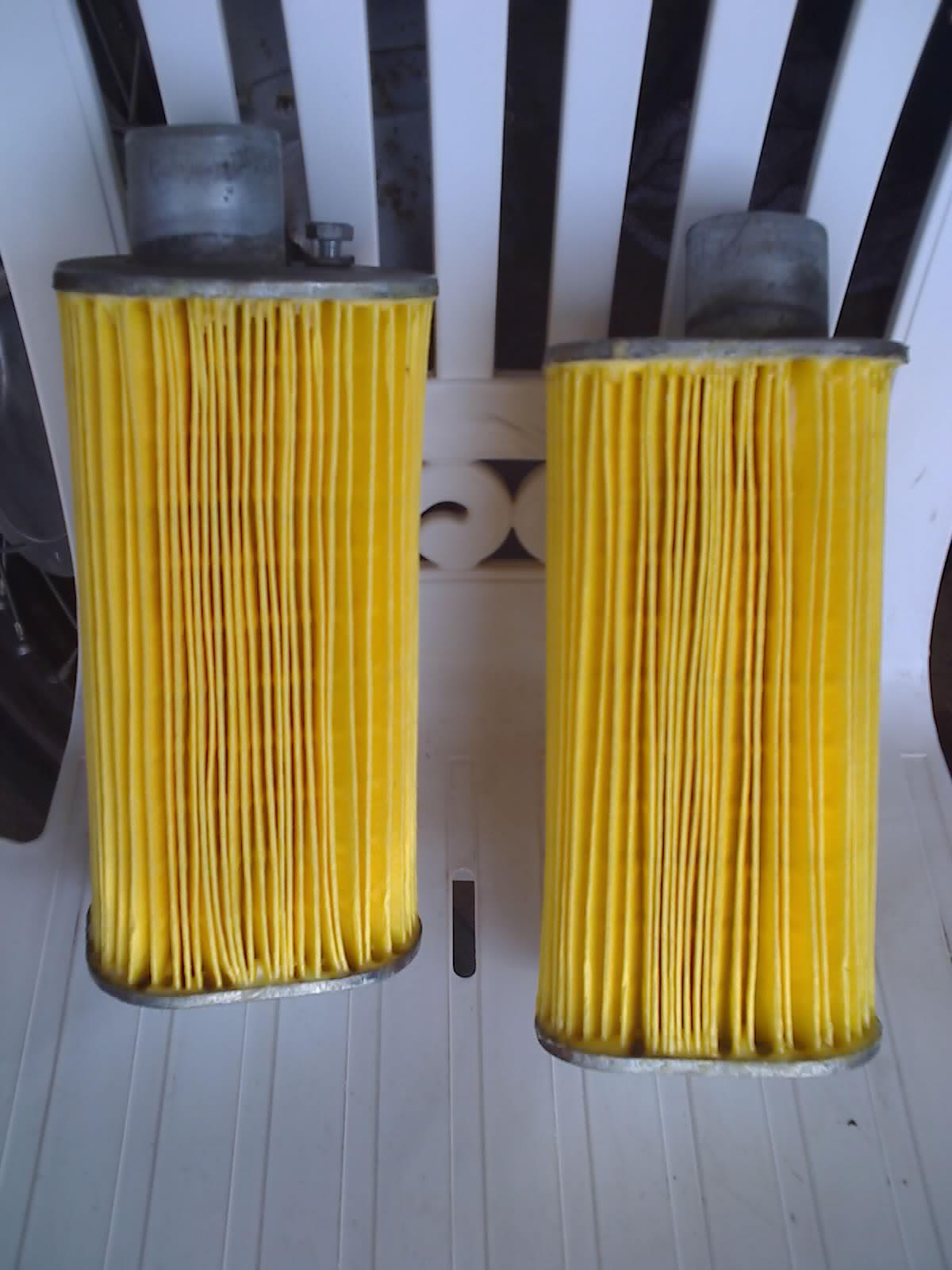

So, at this time I am waiting for parts, so I decided to try something out.  I have not tested this, but this should work.  I thought that this was a great idea and should be shared.  This is how to save yourself some money and refurb your old air filters for $12 dollars and a few hours.  I'm sorry I didn't document the process better.  But you should be able to get the point.  Here are the ingredients: razor or sharp knife, new air filter, glue, your old filter and a few hours.

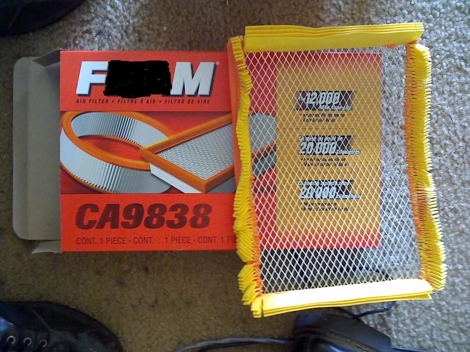

1) Go out to your local auto parts store and grab a F**m CA9838 air filter or similar.  It is important that there is enough paper element in length and height.  After looking through all the filters, this was the only one that I found that would work.  There maybe others, but the shop did not have it.  This should yield enough for both air filters.
2) Cut out the the paper filter element using a straight edge and razor.  Try to preserve the most usable paper element as possible at this point.  Use the razor to cut all four sides (within the factory adhesive) of the filter and it should remove itself from the outer edges and metal screen (see pic "air filter").

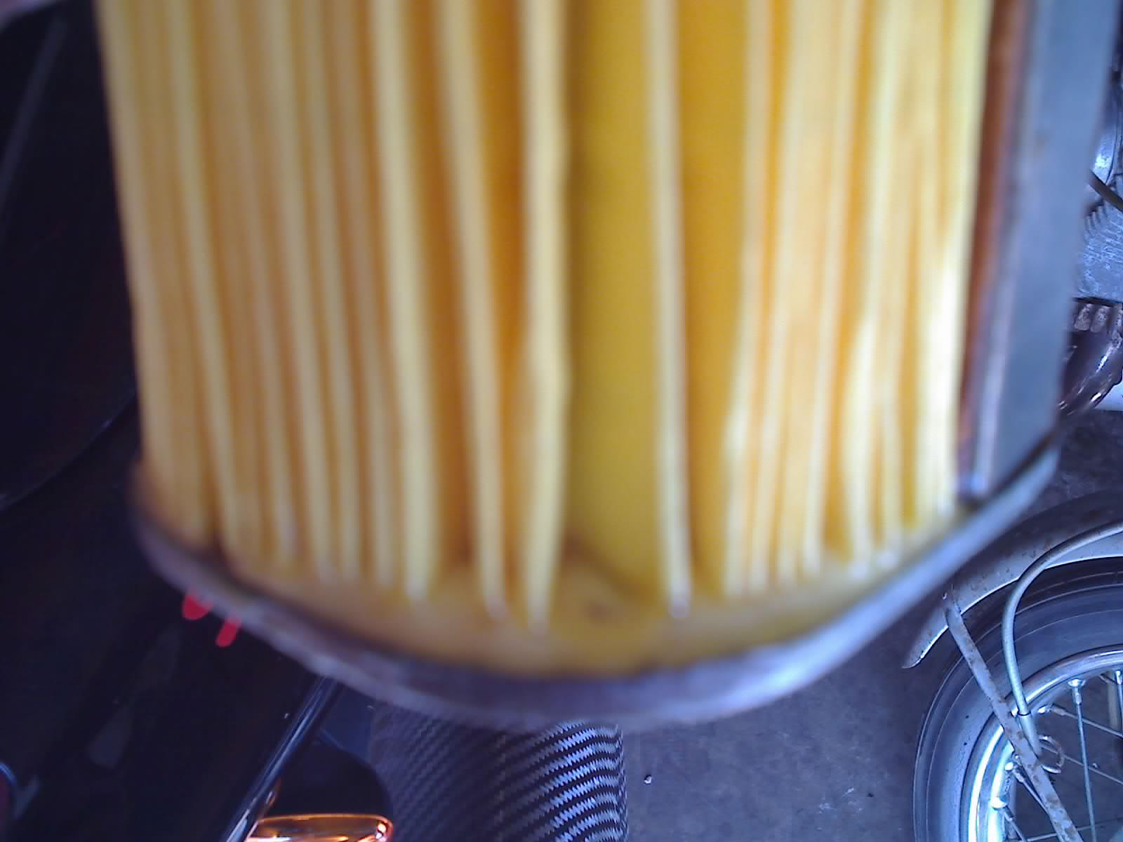

3) Prep the original air filter by removing the paper element and any residual glue you can, keeping the mesh screen intact.  It 's not important to completely remove the residual glue.

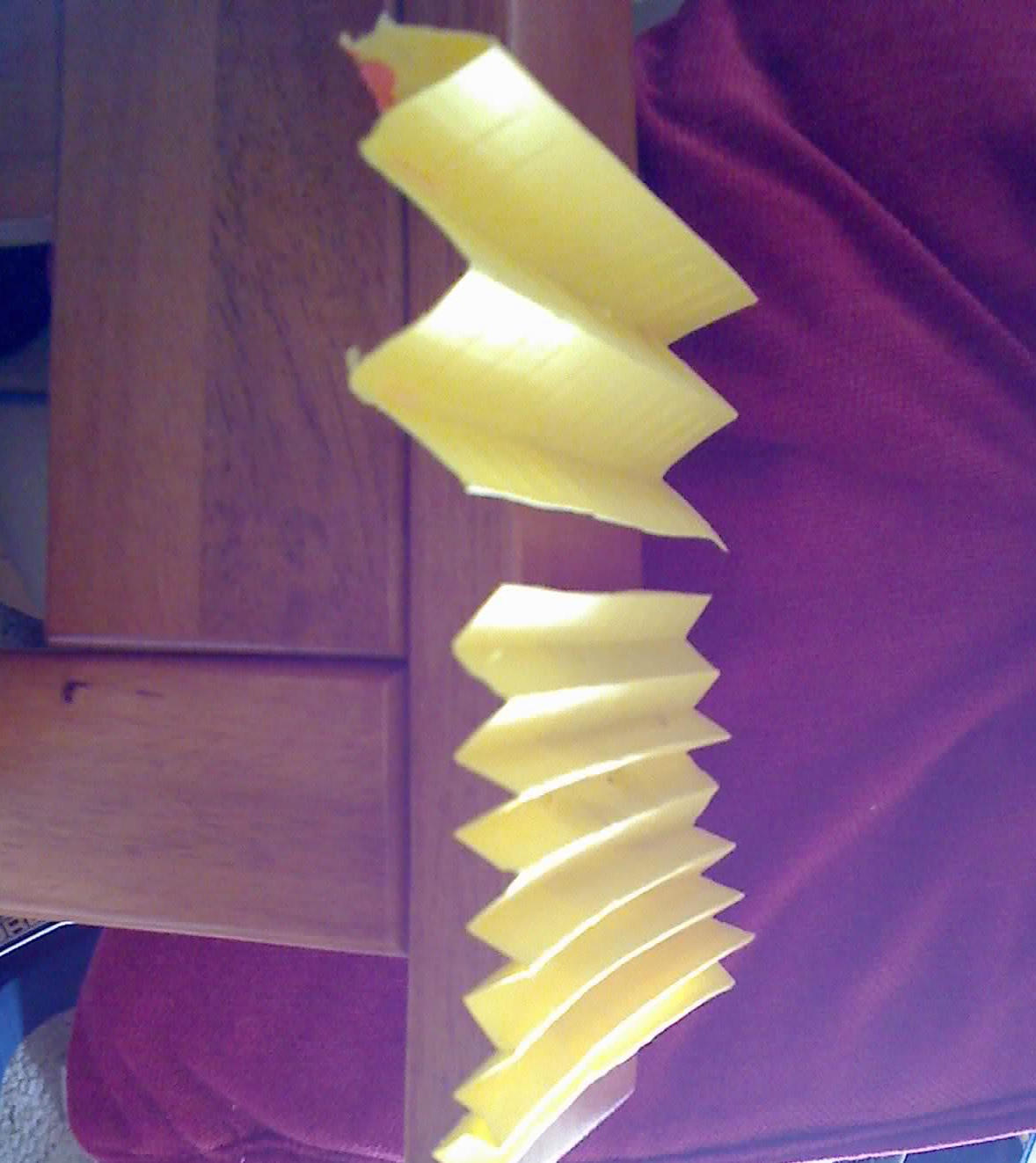

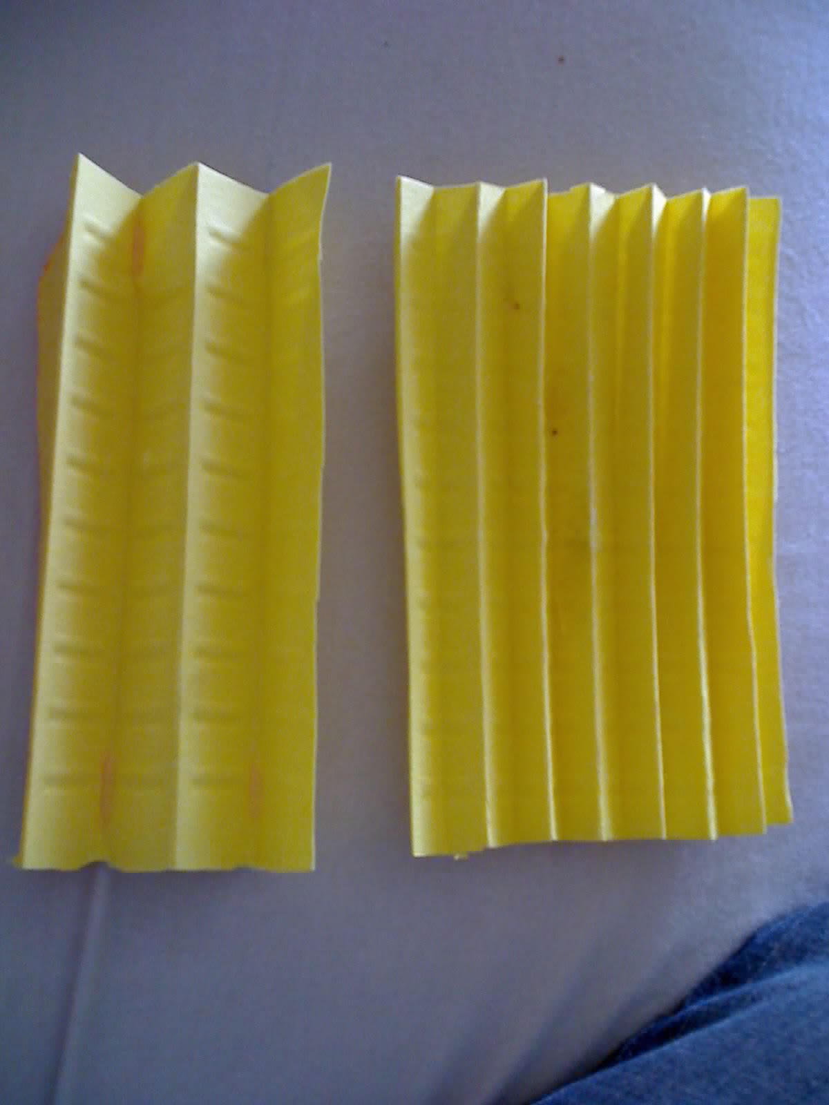

4) Measure and trim the needed length of the paper element (around 6.5 inches).  It can should be tucked under the air filter "end caps."  Now, the width of this filter is just about 2 times wider (depth), so you will need to do some folding. (I couldn't find anything thinner, but if you do, then the whole procedure will only take about a half hour.)  See pics "top" and "side" for the general idea.  Every other "pleat" on the original paper element will be folded in the opposite direction.  This will be the tedious part.  Cut the filter in half (along the pleat) to yield two.
5) Fan out the paper element in each filter housing and apply a generous amount of glue at top, bottom and backbone (I actually tucked the ends between the mesh screen and backbone).  You'll want to make sure that the top and bottoms are sealed using the glue.  I used wood glue.
