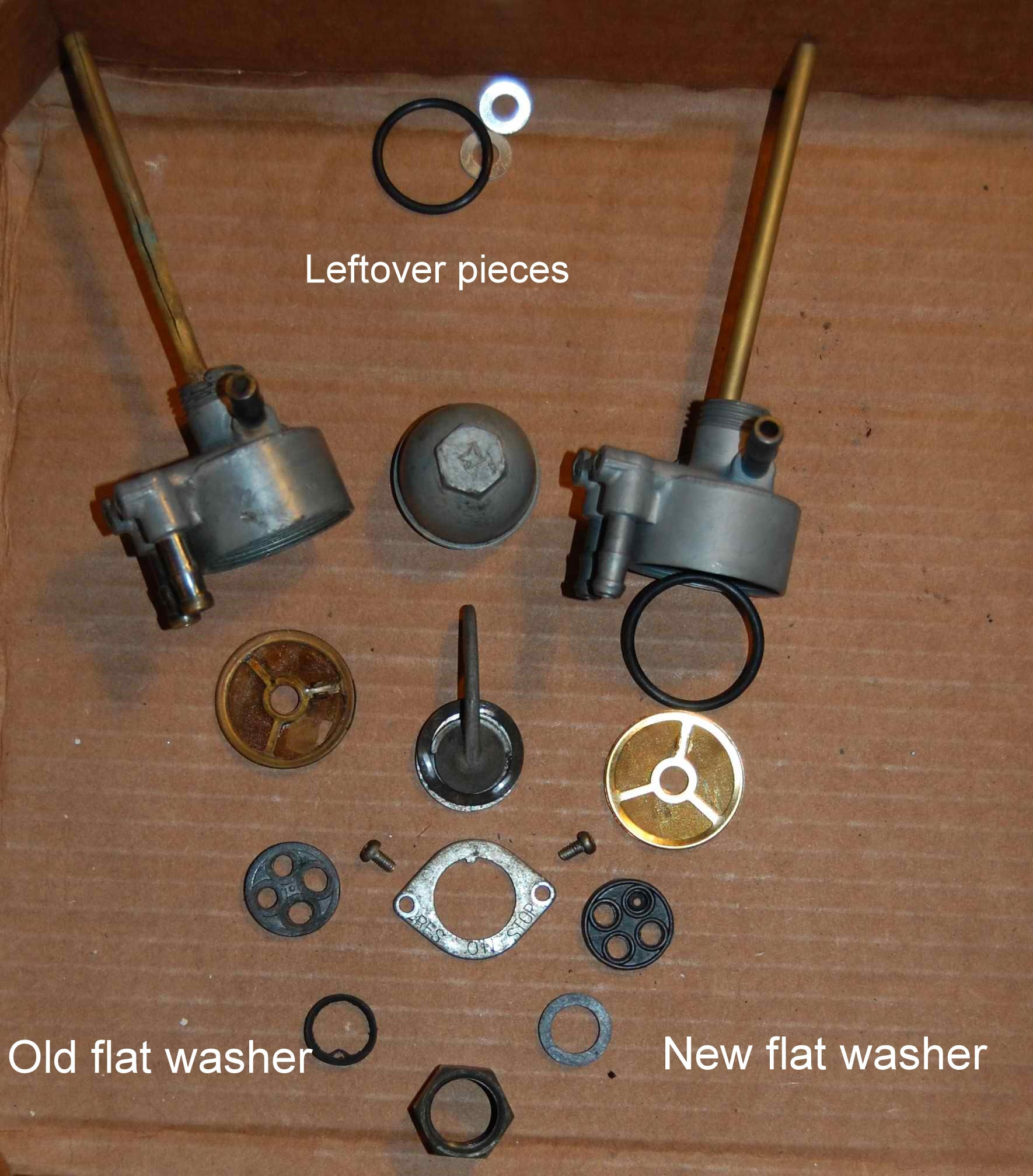

Post by jleewebb » Wed Oct 07, 2009 8:31 am
I don't think teflon tape's gonna help. What came with my petcock rebuild kit was more of a flat washer than an o-ring, though I believe some folks have made a proper sized o-ring work.
Ditto goodysnap's suggestion of truing up mating surfaces on petcock and tank.
Hope this helps, Lee
