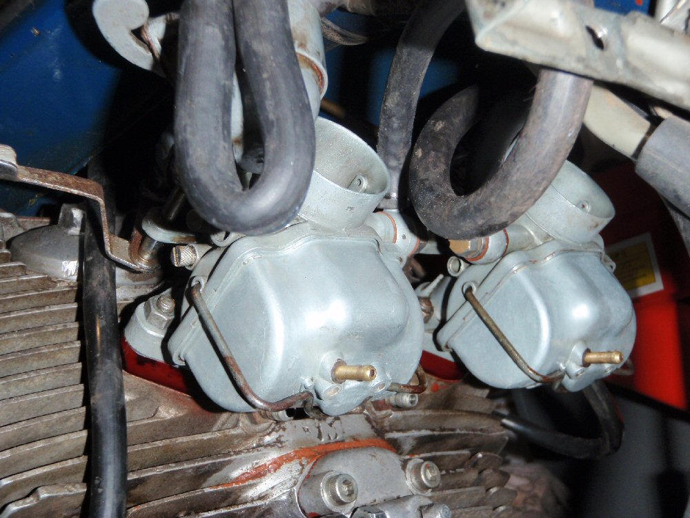

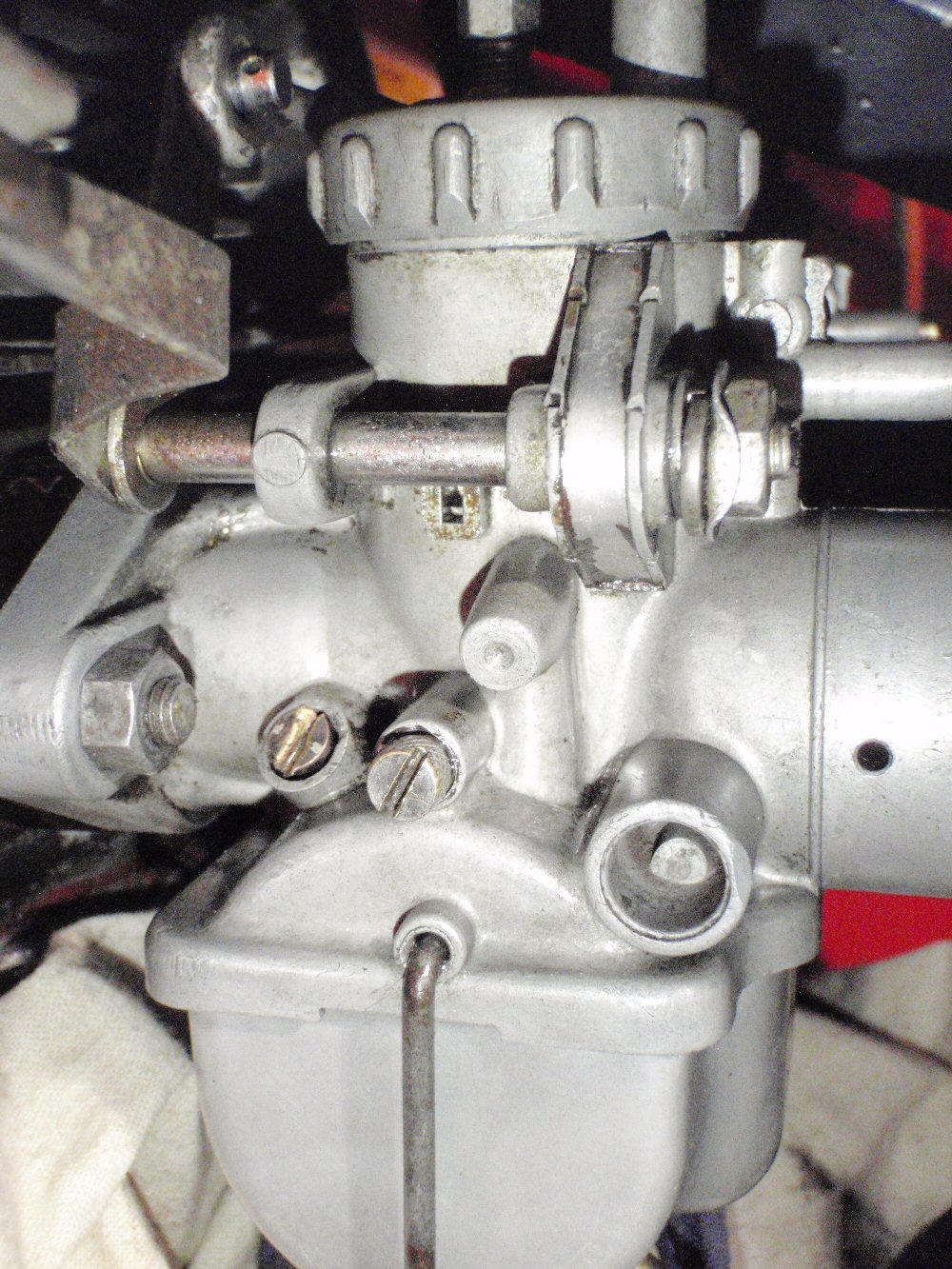

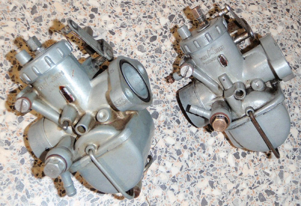

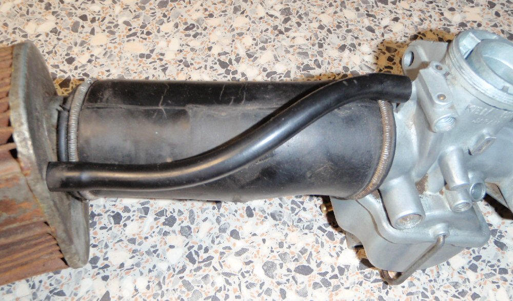

Ed, especially for you I made some pictures, so you can see it yourself
late square bowl powerjet carburator (left) compared with round bowl powerjet carburator (right).jpg
