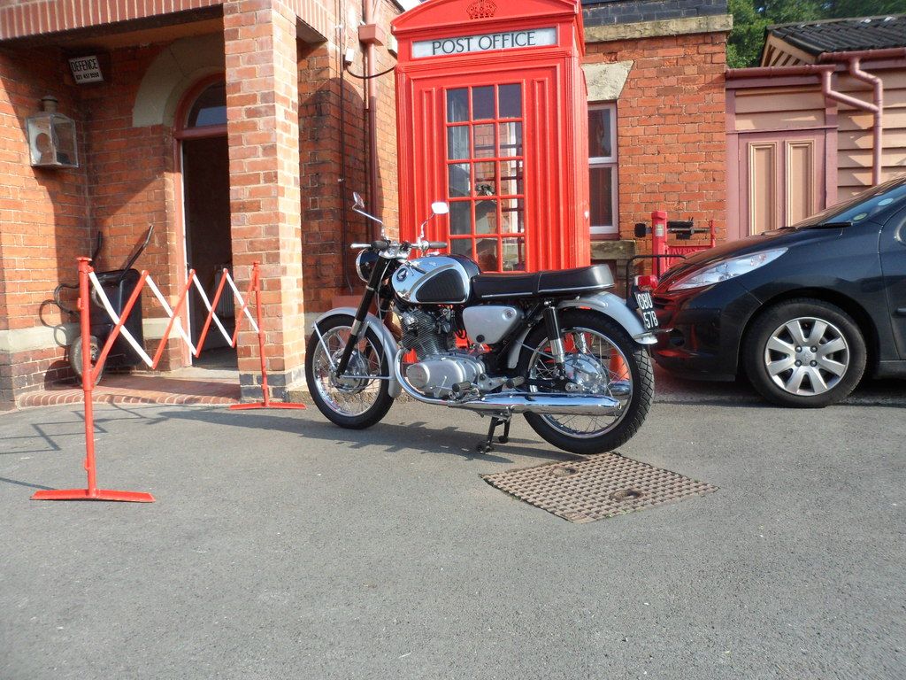

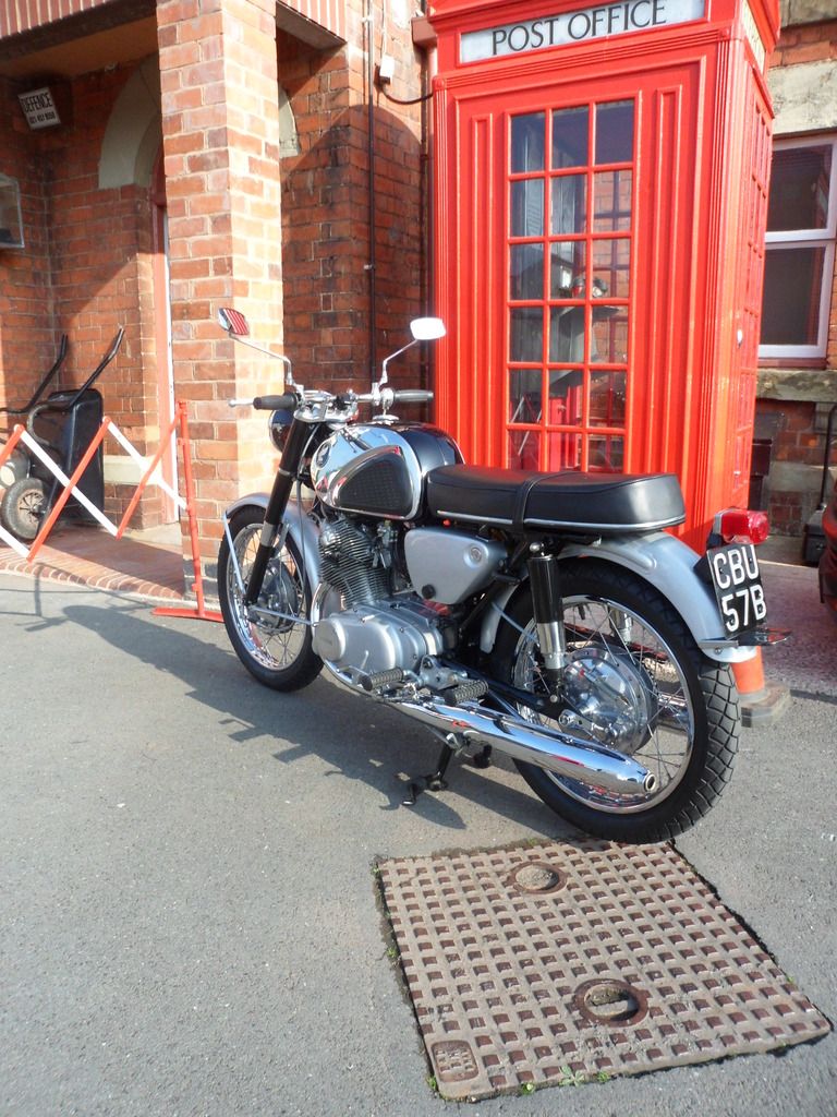

Here's a pic at the Severn Valley railway steam gala in Sep 2015

WOW!
That looks fantastic, I'm amazed at the quality of work in making these old bikes look better than new, some of you guys on this forum do fabulous work.
