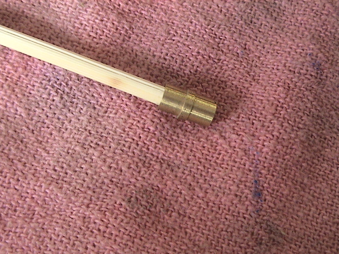

Found the perfect tool at the grocery store the other day for removing/installing needle jets without worry of damage.
Price was right too.

Brewsky..Do you drive them out from top to bottom or from bottom towards the top?My guess is from bottom ?Never took one out before.
Post by brewsky » Thu Jul 07, 2011 5:05 am
They come out by driving down from the top.
The end with the larger opening goes "up" when re-installong.
If you can see a nice round hole when the jet holder is removed, there is really no reason to remove it..unless you can see some kind of damage.
If the hole is egg-shaped, then it needs replaced.

Post by chiboy002 » Thu Jul 07, 2011 12:55 pm
mines kinda seized up i think
do you need to hammer it out or something?
Post by brewsky » Thu Jul 07, 2011 5:15 pm
"Tap" would be a better word for it. Soak in PB Blaster or the like first.
