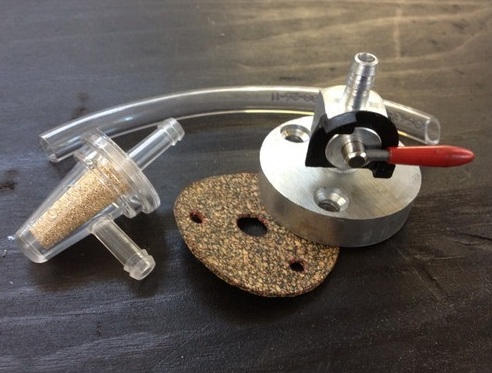

I would just replace it with one of these, my own design:
http://www.ebay.com/itm/271018122754
