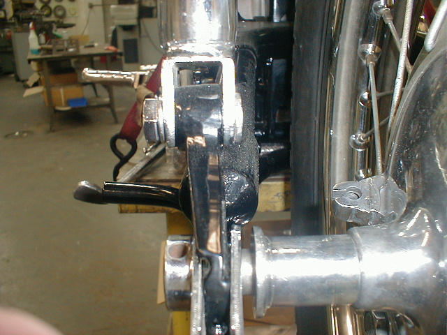

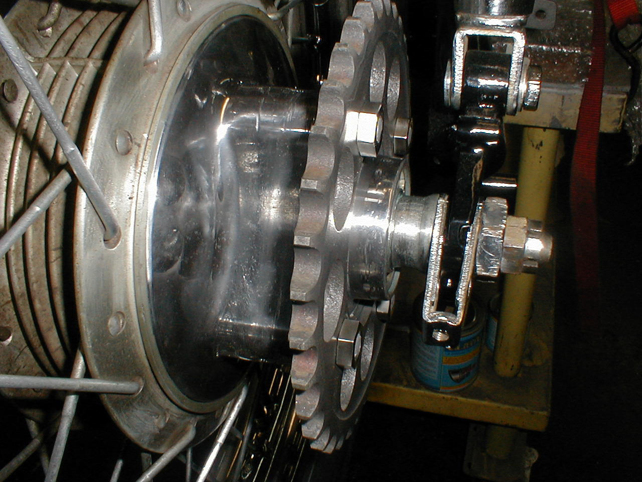

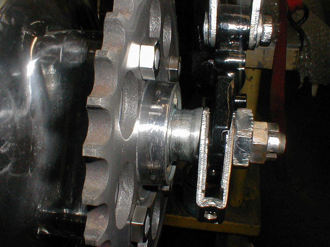

Here are the pics I took of the RH and LH of the rear wheel assembly.
Please keep in mind this is just a trial fit-up and some sprocket/chain adjuster hardware pieces are not ready to assemble yet but I believe all wheel and spacer parts are where they should be.
In the RH pics, looks like I have everything in place and I have pushed everything towards the RH side.
As you can see, there is a gap between the LH chain adjuster and the axle spacer of approx 1/4".
I must tell you that years ago, my original rear wheel and tire was stolen and I ran an 18" wheel and tire off another Honda bike and MAY have altered the spacer to get everything to fit.
Now that I have a year correct wheel and tire for a 1965 CL77, I'm thinking The difference in the two wheels may be the 1/4" that is now showing itself as a gap.
Looking at my parts manual, It also looks like the spacer shold have the larger diameter on both ends, not just the outer as shown.
If I tighten everything up to eliminate the 1/4" gap, I will put too much bind on the swing arm arms and force the axle nut to the bottom of the axle threads causing a NON alignment of the cotter pin hole with the nut.
I'm thinking I need to make (or acquire) a different axle spcer for the LH side.
Can anyone verify the width of an original 1965 CL77 Axle spacer??

Please measure both spacers. As this is a small brake you may have the wrong spacers all right.
Not to worry. I have spares here. ...........lm
