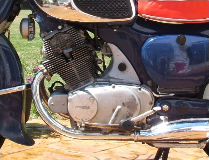

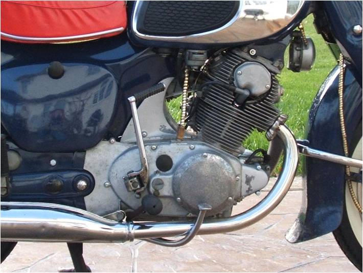

Thats kind of tough to measure so here's a stock exhaust setup on a '66. Maybe you can scale it of the pictures. You can see the right is about an inch longer than the left by looking at the footpegs, and the headers stick into the mufflers about 1-1/2 inches as I remember. Steer clear of any headers from Thailand. You're better off trying to find used OEM's. They will be rusty on the inside, so not that noticable, just try to find some without a lot of dents.
